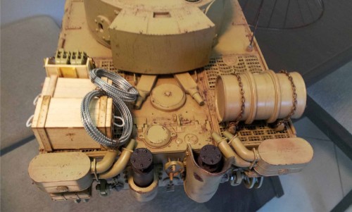

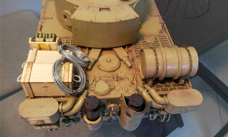

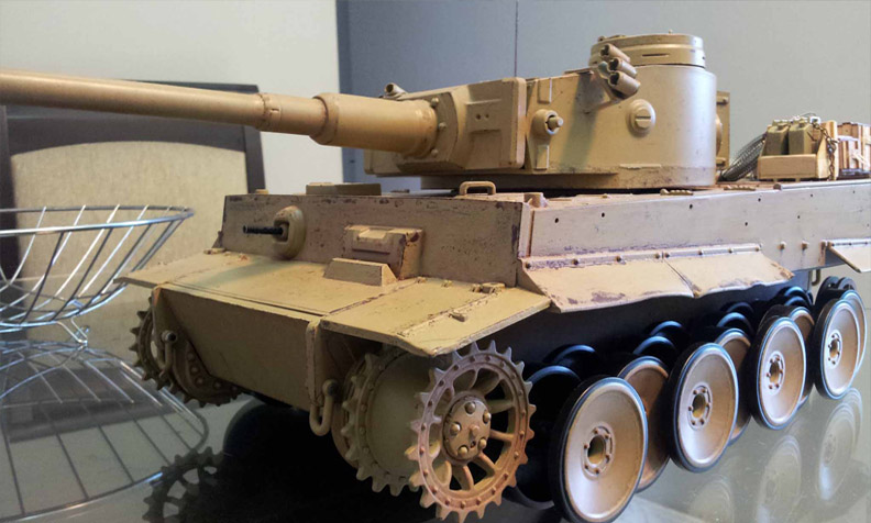

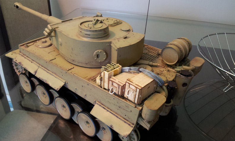

This is my first Attempt to modify a remote control tank. I used one Heng Long Tiger 1, but I'm not satisfied with the Heng Long electronics. What would be the best option: Electronics from Tamiya or El-Mod? Can anyone tell me if it is too difficult to install these options?

Please do not take this the wrond way......Tiger crews/ most tank crews as a rule would not cover their air intakes for the cooing system.
Here is a pic of a model showing whats under the read deck...

no.....found it on photo bucket, i just want to show were the cooling system was. The tiger was prown to over heating....a there are many photos out there with them driving around with the armored grates wedged open.

The objects on the grates are just for display on a shelf. They are not glued on the grates. I run the tank without this objects.

For your first attempt I think it looks great, as for your items on the back whilst it may or may not be correct if you like the look thats all that matters mate.
Great job
