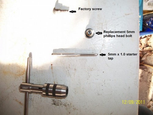

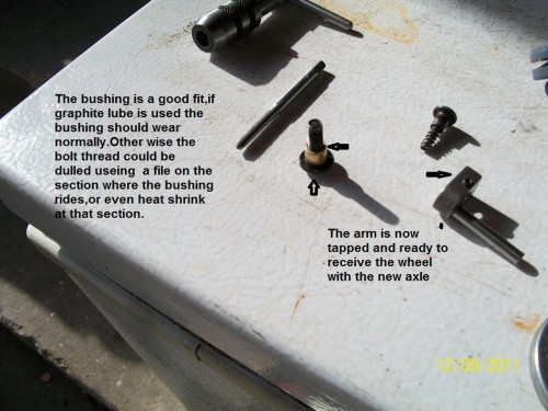

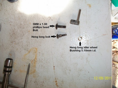

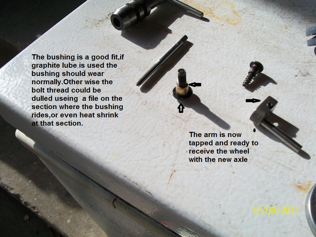

Not sure of the missing parts issue,Seems your missing the bushing,or don't have the correct type of bolt?
Which vender did you use, because their is a very good reason we use certain venders,they send the right parts each time.
But I tried with the instruction to use the stock bolt. Well it will come loose,the method I have used here secures the wheel,and the tracks have not left mu Jagdpanther since this modification.
The Tiger is the same,and this will work,but you have to find the bolt and tap. I am fortunate and have many resources like hardware and tooling.
Before you spend to much money you might consider the Asiatam.Taigen Tiger lower hulls,Welshdragon has them on sale for 49'95. and they solve all the Tiger lower hull issues,my Hull is almost two years old and has never thrown a track or failed to give excellent service.
If further help is needed please pm me.
http://www.welshdragonmodels.co.uk/taig ... -512-p.asp
Cheers Saxondog
