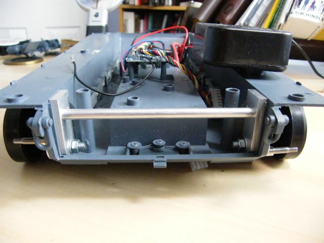

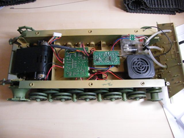

Easiest way I found for taking the track pins out is to remove one at the drive sprocket, as Ruben says push them inwards. Once you have the tracks removed there are six screws in the sponsons then it comes apart ok, although Matorro aren't overgenerous with the amount of slack in the cabling to the upper hull:

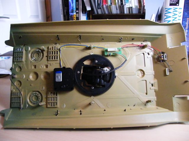

You will need to get the soldering iron out to take the turret off as the wires are soldered to the upper hull socket:

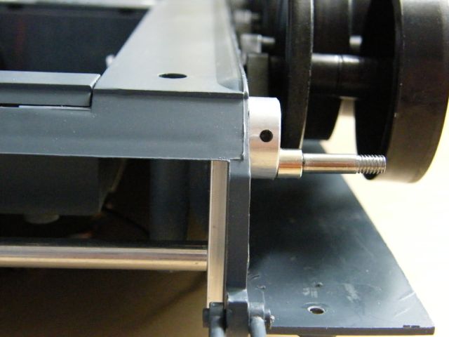

As for the Tiger I idler problem, yep, suffered that, figured it was down to the wobbly idlers so sorted mine by fitting a set of Tank Modellbau track tension adjusters and metal idler wheels from Steve at Welshdragon, this really stiffened the rear of the hull:
