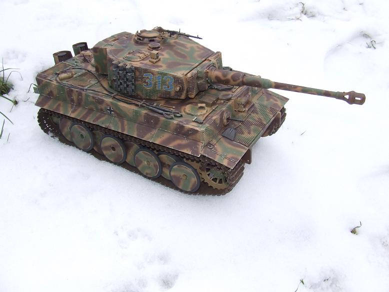

NickDonitz
Posts: 386
Joined: Sun Jul 31, 2011 8:52 am
Re: Dulling shiny plastic?
Post by NickDonitz »
Go with the strip it down, prime it, spray it option you can get a cheap airbrush at a local hobby store, its great fun to learn .. I use humbrol / revell enamels or Vallejo acrylics practice on card and watch a few youtube lessons some are great ive added a pic of my Tiger as an example lots of light coats let them dry between and if you make a mistake you can always spray it again in 1/16 th youd have to really layer it on befor youd loose detail deffinition..... have fun

Beautiful tank, buddy. I'll go the airbrush route. Thanks!
