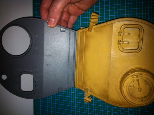

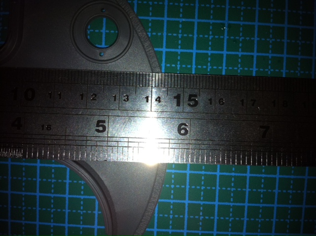

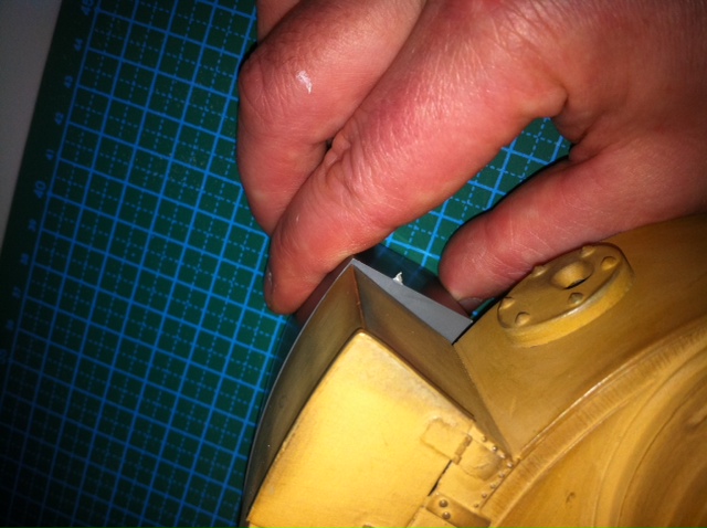

by The Tank Man
The site that the Blimp has there is very good! Helped me work out a few things I dident know!! It alls has the turret dimensions !! I'm going to post some picks of my tamiya turret against the henglong one and the storage bin a bit later on ! So you can see the differences. Now the towrope holders are simply been put in the wrong place!! I thought it was the towropes that mite of been wrong so I got some tamiya ones and they don't match up either lol so I ground one off each side and because I had a spare hull I cut them off that and fitted them on mine to solve it ! Rite off for my tea now I'll post them pics on mite be about ten ish !! :thumbup:

heres some pic of a tamiya and henglong turret

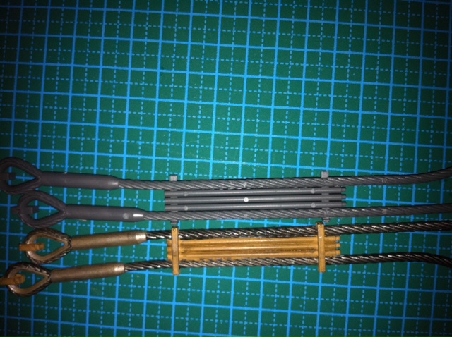

by The Tank Man
heres the towropes the tamiya is the gray one and the painted one is the henglong hope this helps oh and one more fault is the turret mantel pivot point is wrong it should pivot on the lifting points the henglong pivots on separate hinge in the turret that is two far back so the mantle pivots wrong this was done to accommodate the bb gun system :thumbup:

by The Tank Man
with the towropes the tamiya one still wont line up with the hull!! :crazy:
