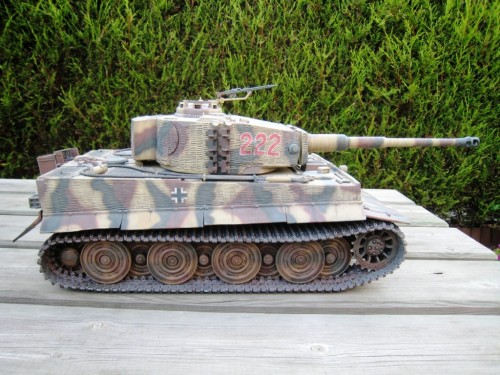

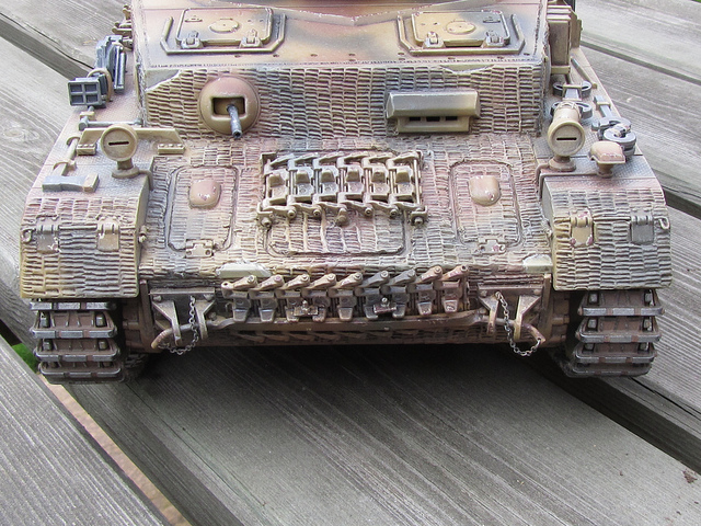

Here is a couple of pics

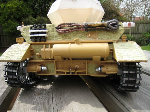

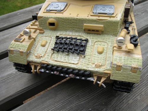

Here is my attempt . I always use milliput.
Pz.IV based Ostwind.
Stug III Ausf.G waffle pattern zimerit

Thats a great job with the waffle effect Andy. You made that tool yourself, carved out of wood correct.

Thanks Steiner , yours is very good to . Yeah a length of hard wood , I just cut slots in the end both ways to form the design .
