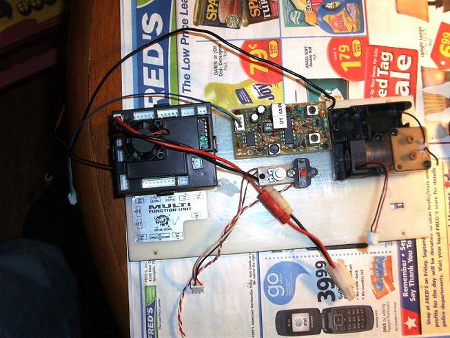

Guys their is an old thread on RCU in the tanks section where me.Dan AND Normond started this adventure. We did just about every thing we could to improve the original unit.
The problem always goes back the the heater element, and that was the issue of reliable.The noise issue is an easy fix,remove the pump assembly,replace with small fan,same two wires that powered the pump motor power the fan.
Look in the Photo,The H/L smoker I first fitted to my Asiatam Tiger has this mod.
