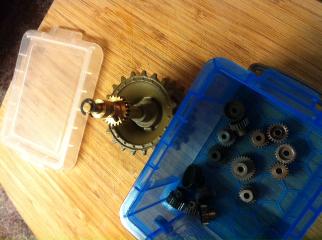

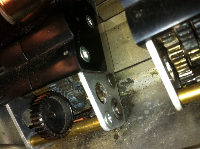

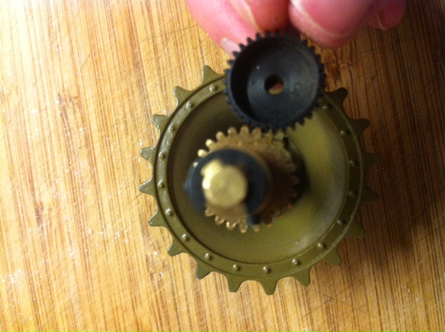

heres the 48 pitch against the gears in our tigers
you can se that the 48 pitch is no match and the teeth dont mesh at all heres some more pics
heres the tamiya gears and it fits like a glove!!!!
heres some of the pinions i have in 48 pitch im not sure what the pitch is on our tiger gearboxes !! but i would like to no!!!!! 8O
