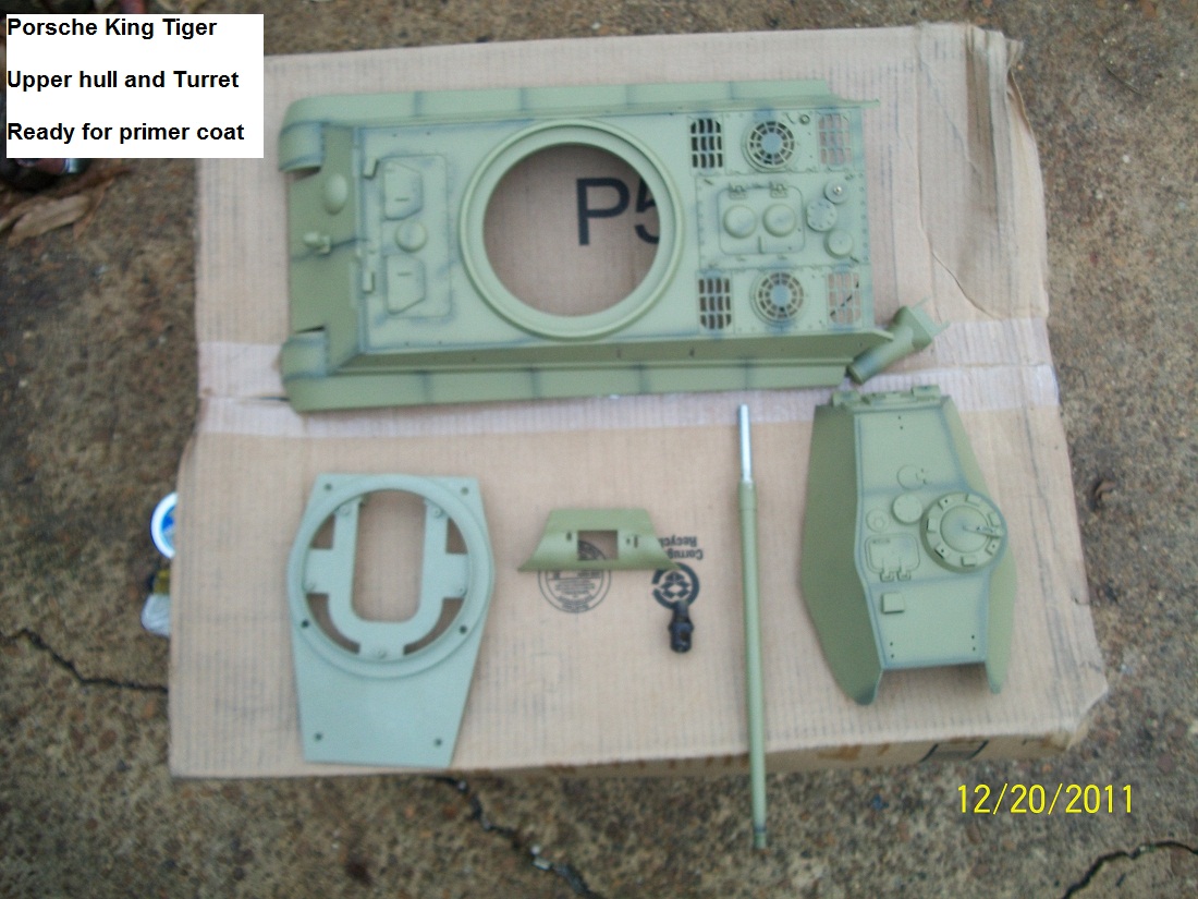

To begin with this is the Waltersons King Tiger as first produced,their paintwork sucked. This is an example of why that really did not matter as most guys want a better paint job anyway. Hope you guys like this,it has been a lot of work,still much to do but here is where I am so far.

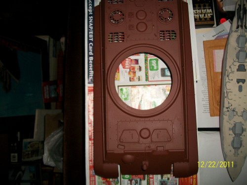

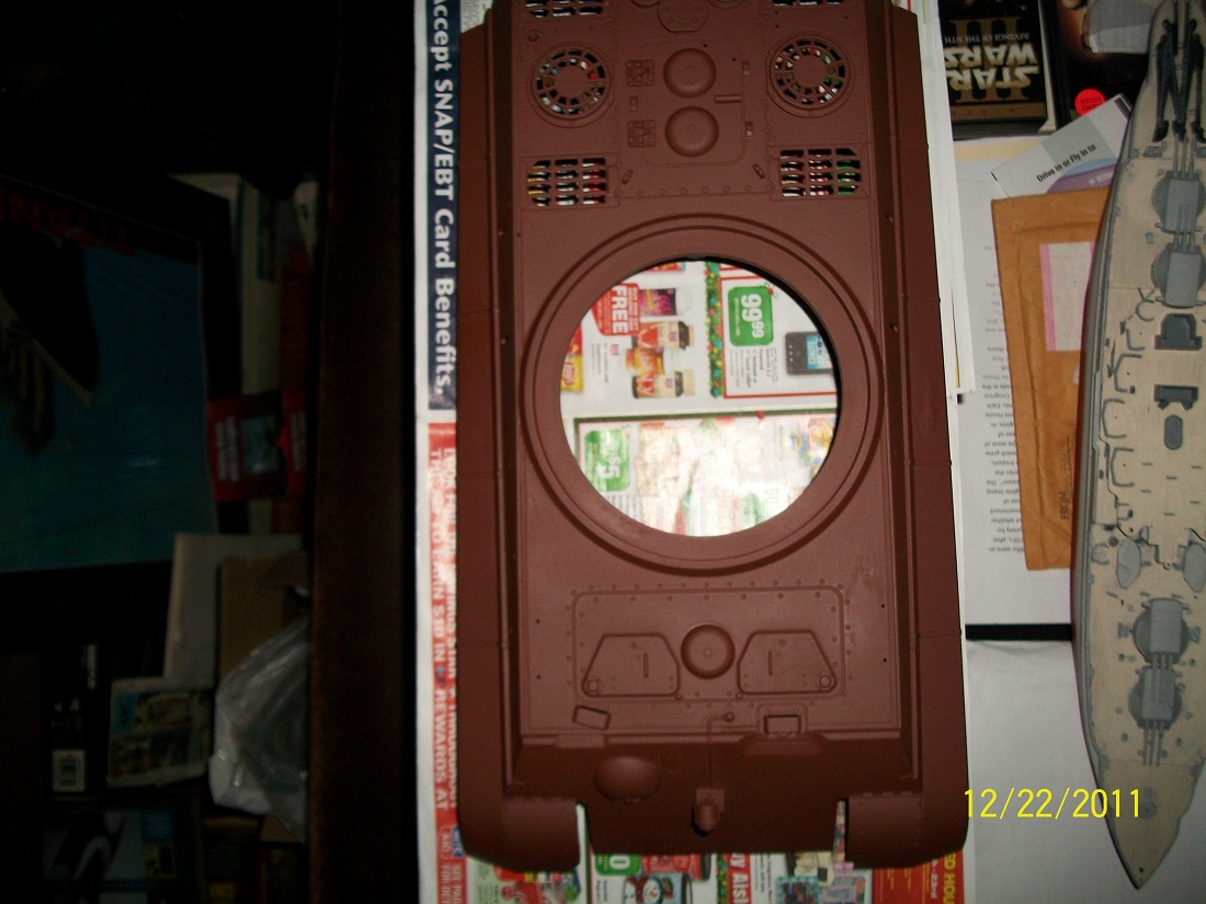

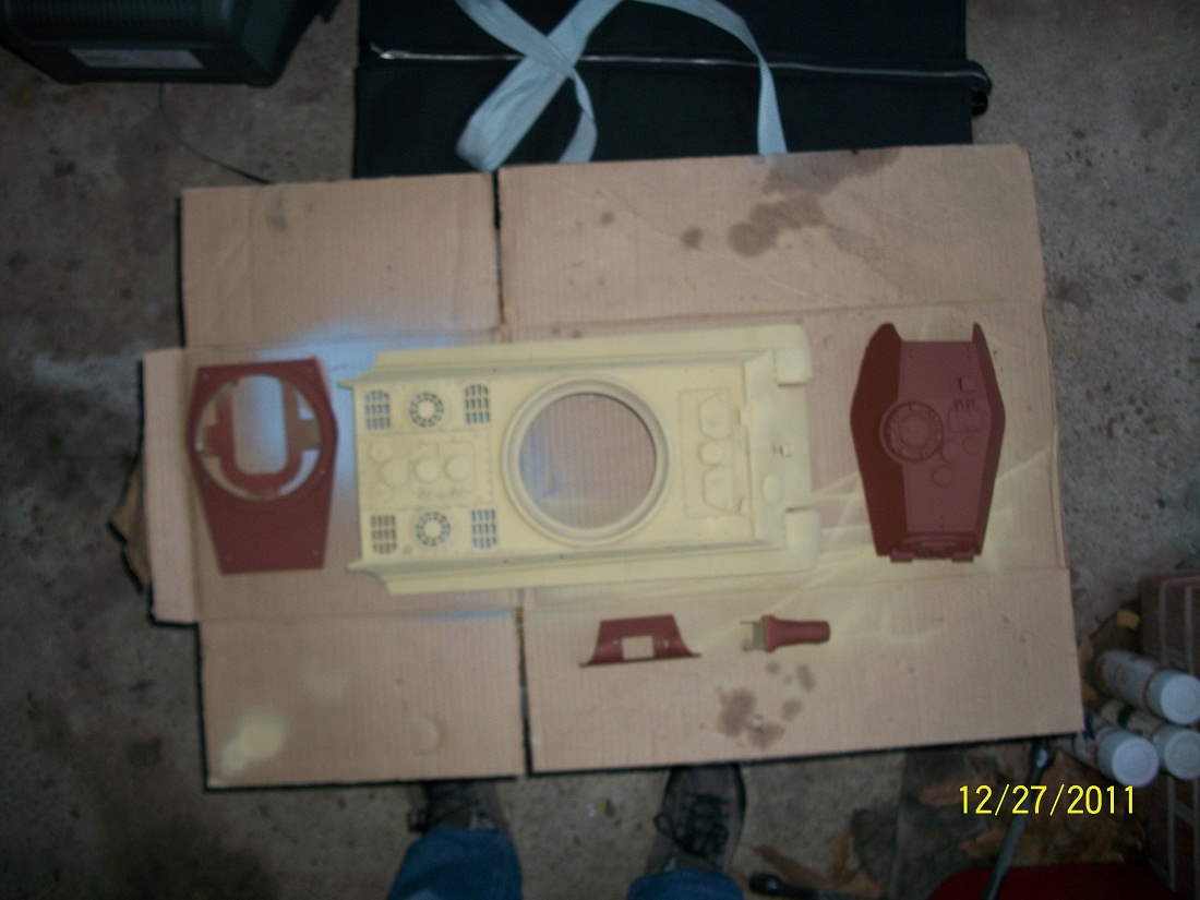

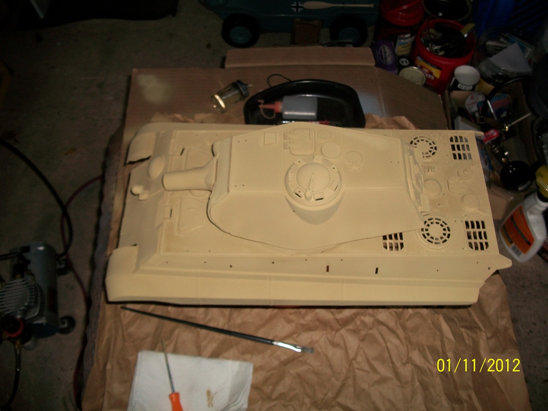

PRIMER COAT
PRIMER COAT

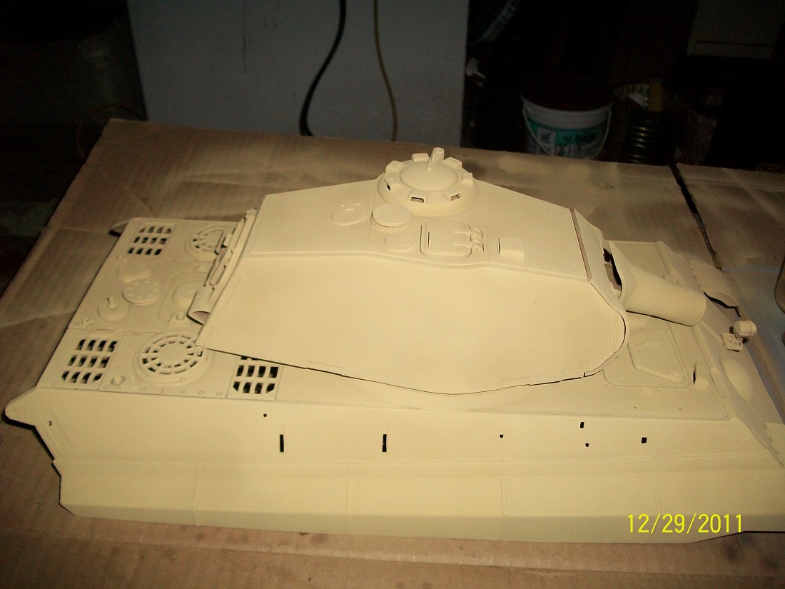

Primer coat using Rustoleum Rusty metal primer,48hrs dry time

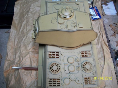

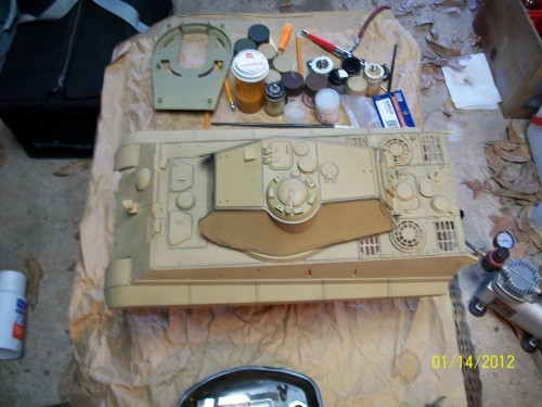

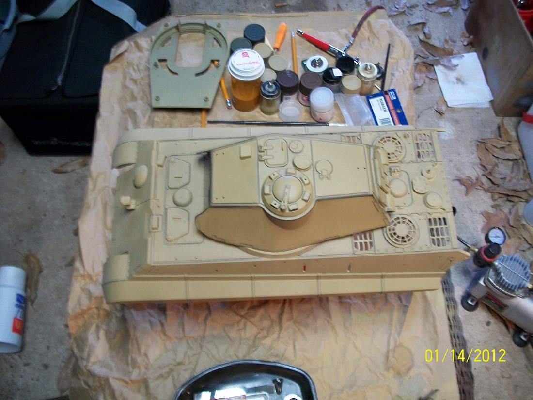

Primer and Base coat stage I
First base coat Tamiya XF-60 MIXED 50/50 RATIO
Base coat II
Base coat II
Second Base coat, Tamiya XF-60 mixed 75/25 Ratio

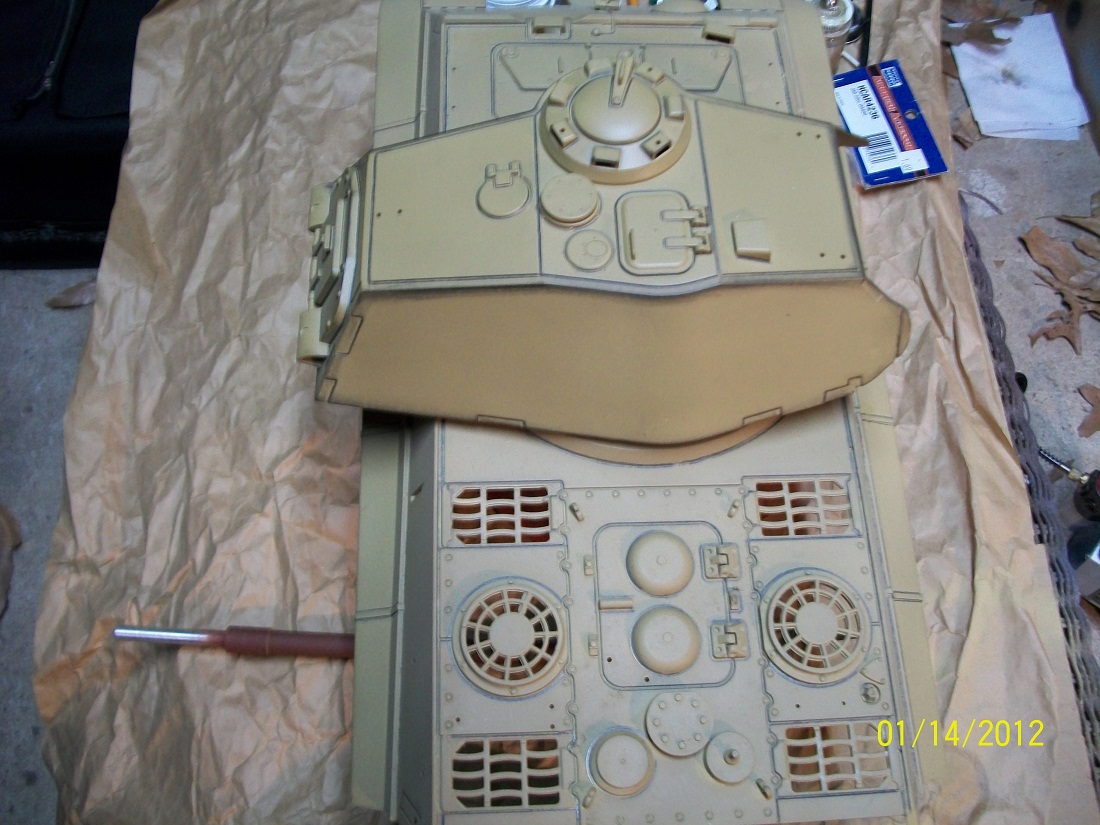

Base Coat III
Base Coat III
Finale base coat Tamiya XF-60 straight misted application.

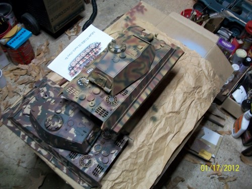

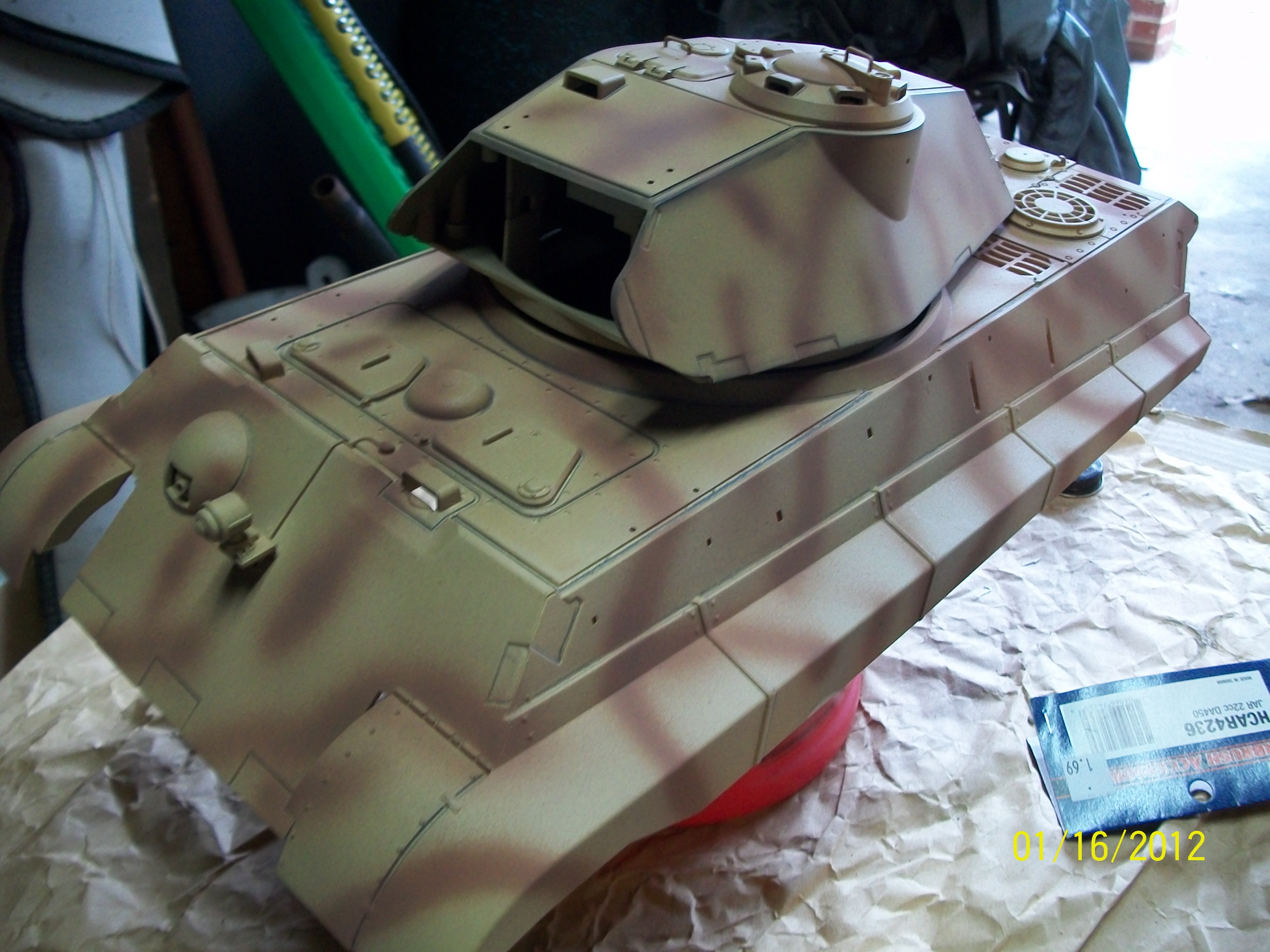

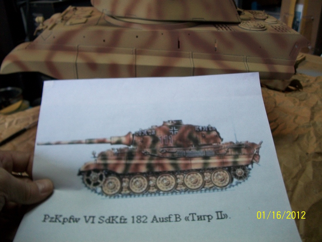

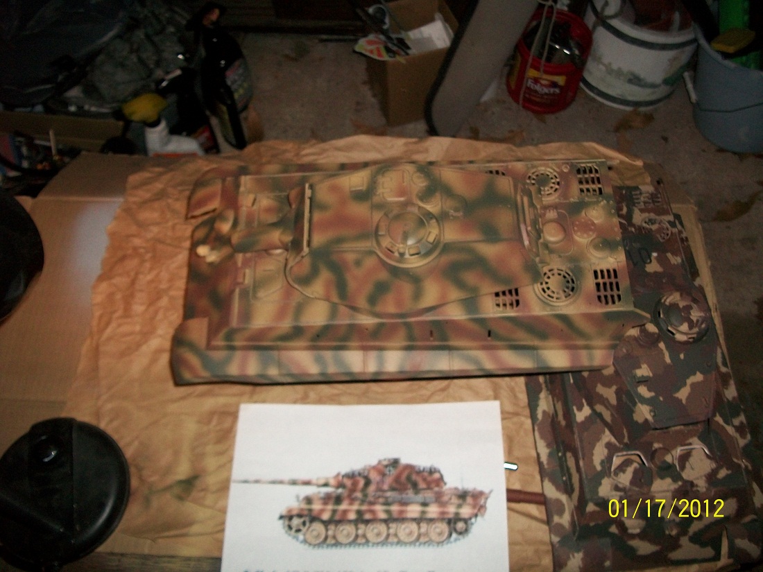

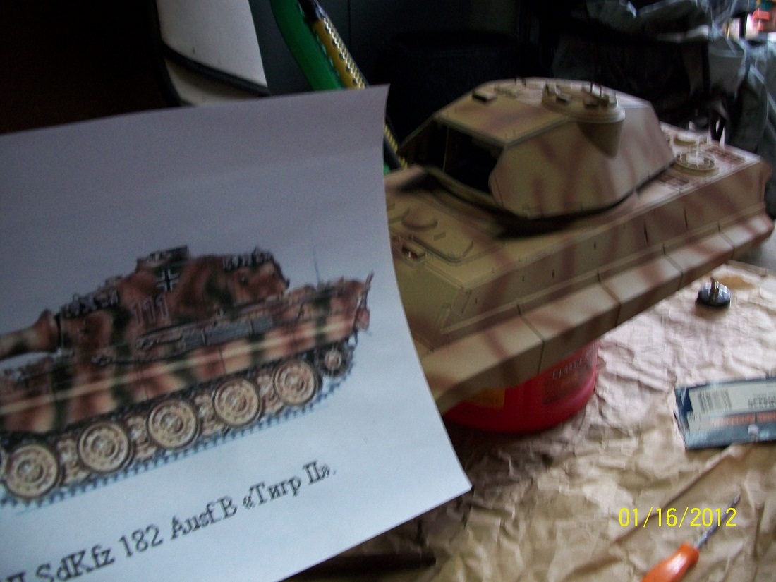

Today the weather changed and I DECIDED TO GO FOR IT! Camo from a single view of a tank is very difficult. The overhead view of this examples would be better,yet we seem to have to use what we have,and this is what I have done.

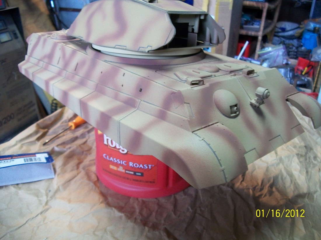

Stage I of Camo Scheme Red Brown XF-64 75/25 RATIO
Red Brown mixed 75/25 Ratio

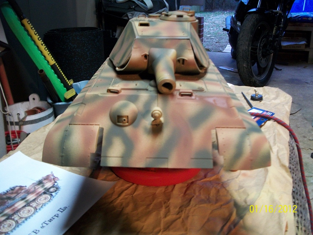

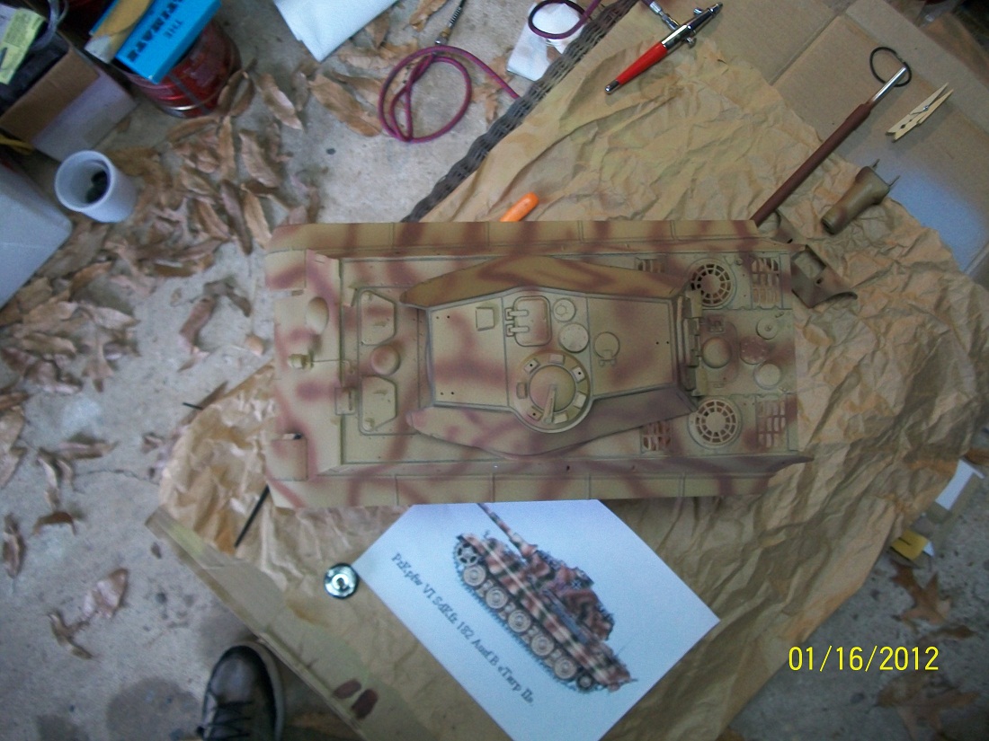

Over head view
Over head view
This is the most difficult thing about having only a side view,what does the view appear as from Overhead? All we can do is what we think they would have done,and hope it looks correct.
Also I painted the lower hull first,the sitting the Turret in place painted it,this works best for me.

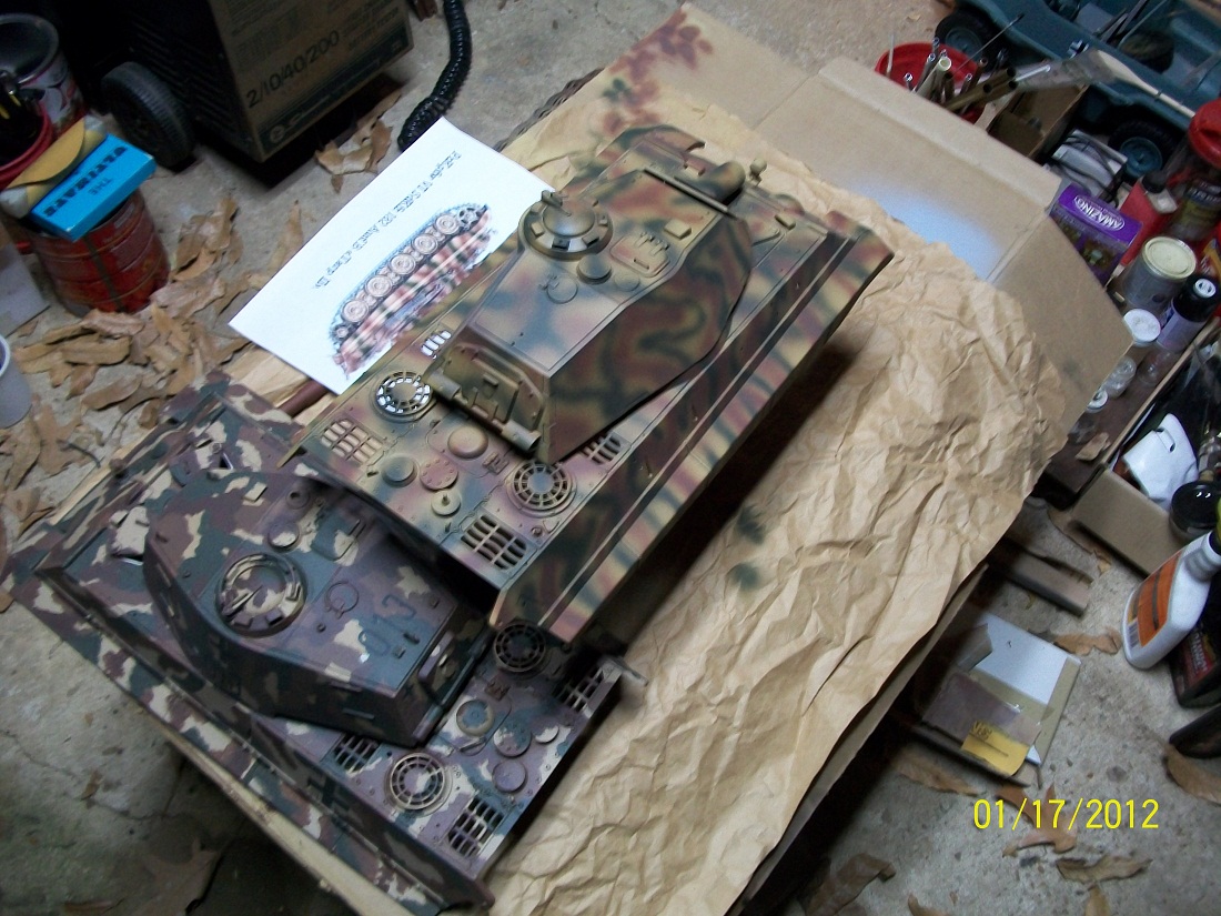

Saxondog
Posts: 4293
Location: Tennessee-U.S.A.
Re: Porsche King Tiger (Waltersons)
Post by Saxondog »

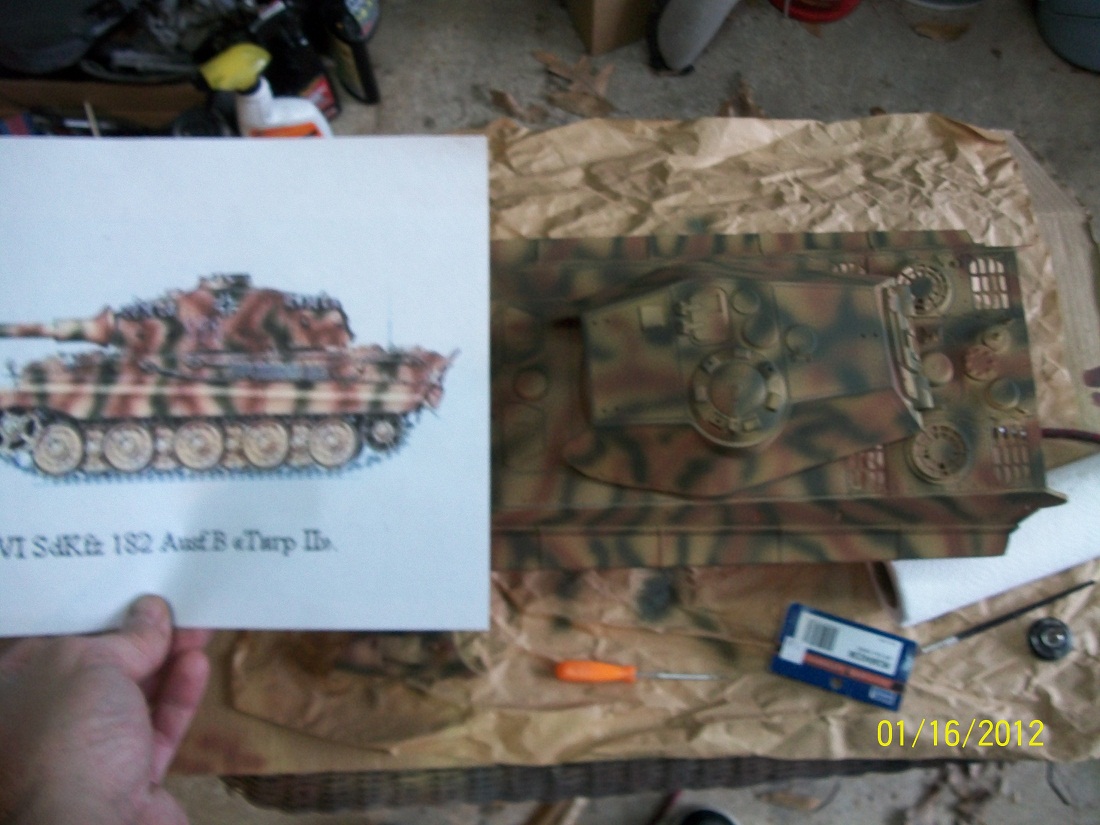

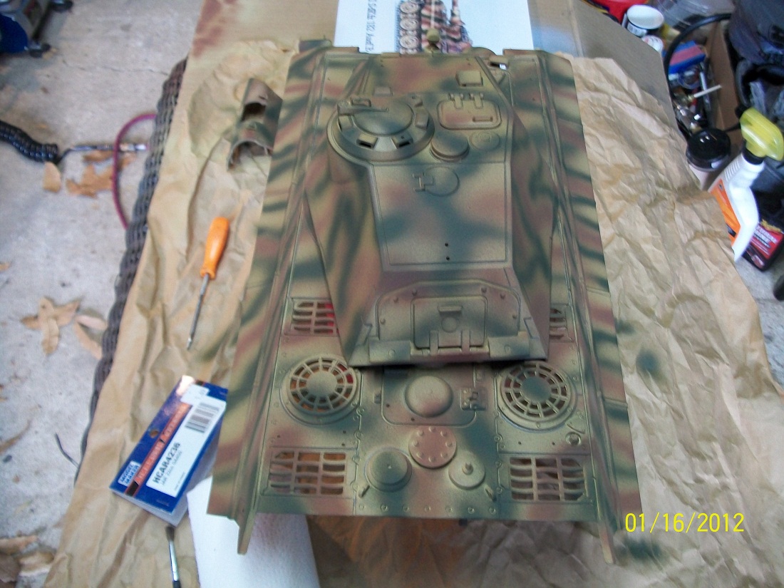

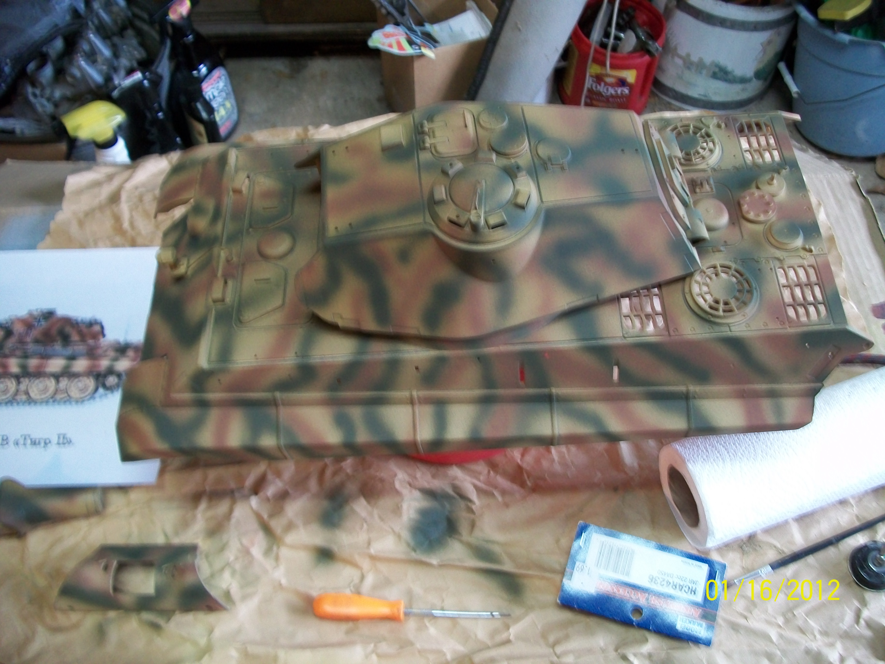

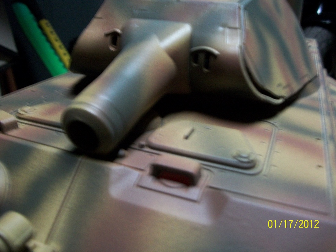

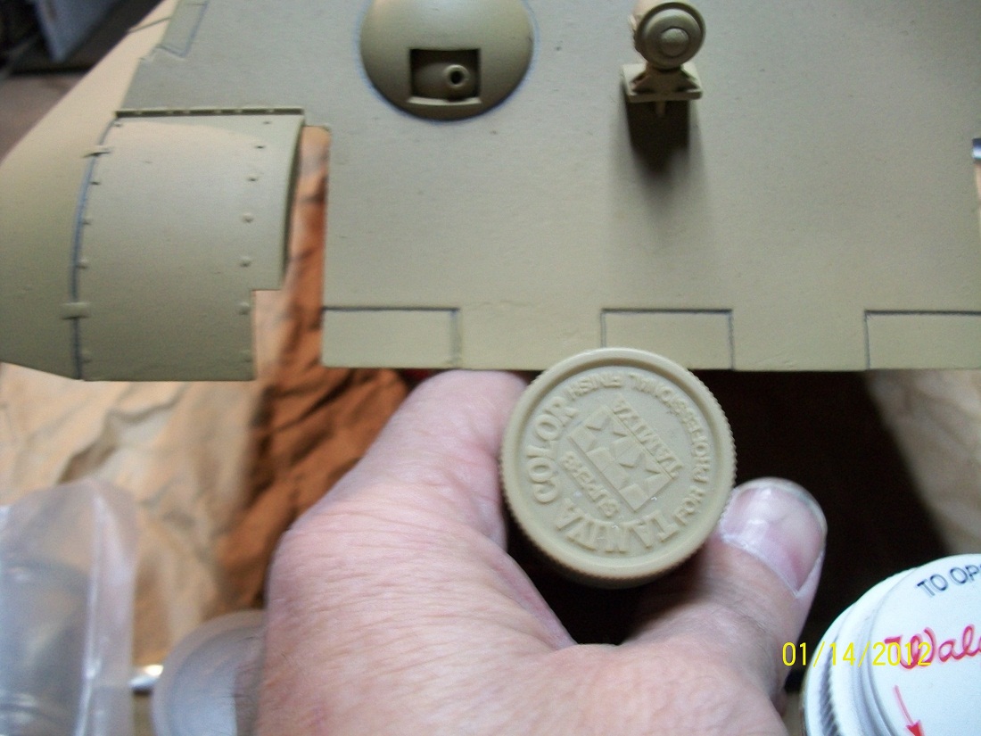

Now for the Green,the Tamiya XF-61 is really dark,the XF-58 Olive Green is used sometimes but seems very Olive drab (us) looking to me.So I first thinned the XF-61 75/25 Then added a small amount of the XF-58. I use Pill bottles to mix in,they have a rubber air tight seal and work very well as you can shake the hell out of the mixture and ensure a good blend of colors and thinner. Alcohol is used for thinner.(Thanks Steiner)
The first try and a decent match as far as I can tell.
Still much work to do,but the basic concept of this scheme is complete,the Floor polish/Matte base coat will add depth and change the tone. If more color or strips are needed they can be added later.The sealing the Floor polish mixture creates still allows other coloring or methods like washes to be added. Now for some over night drying,I did allow a full Hour or more between colors as a dry time. The Alcohol does evaporate fast drying the paint quickly.
