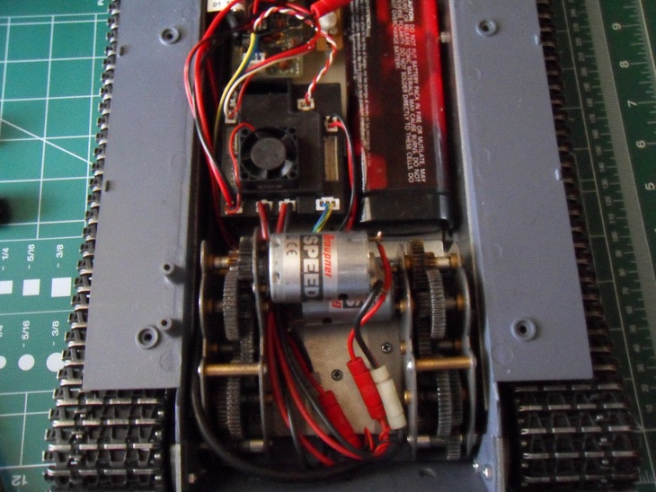

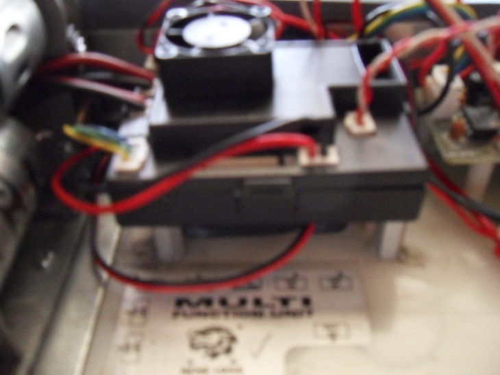

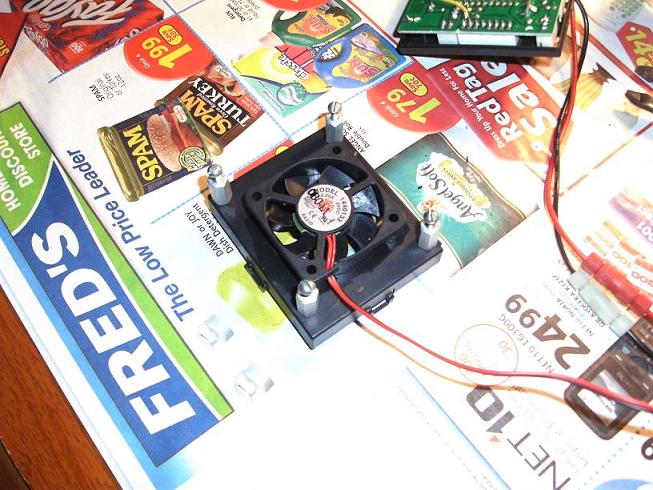

Post by Saxondog »
The one upgrade that in addition to your motors would be fan cooling the RX18 Board. I chose double fans and an elevated unit. Over two years of running with no problems,my pinion is 12t, but 13 should work fine,I'm a little fast for scale but it is the durability of fan cooling that I am pointing out.
The post of how I installed the fans in on this forum,the bottom fan is very large pulling air through the unit and discharging into the bottom area also helps to keep the cooler bottom air moving around the hull.http://www.rctankwarfare.co.uk/forums/v ... +RX#p74649" onclick="window.open(this.href);return false;
