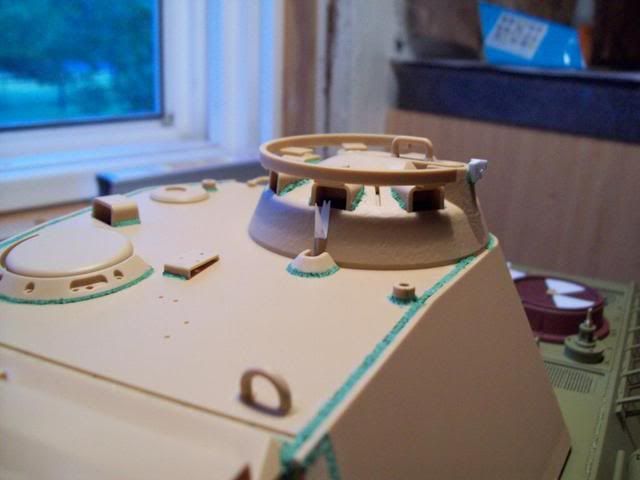

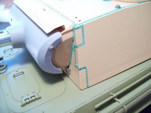

:thumbup: Plastic sprue is an excellent way to do welds , attached and softened with more liquid polystyrene glue working the beads and ripples as you see fit .
  • Image
*Tip - I 'painted' the adjacent areas with thin superglue , scratching through to clean plastic before applying , this stops the solvent affectng the surrounding plastic ;)

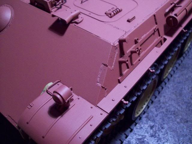

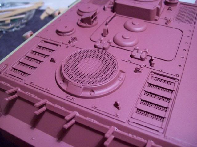

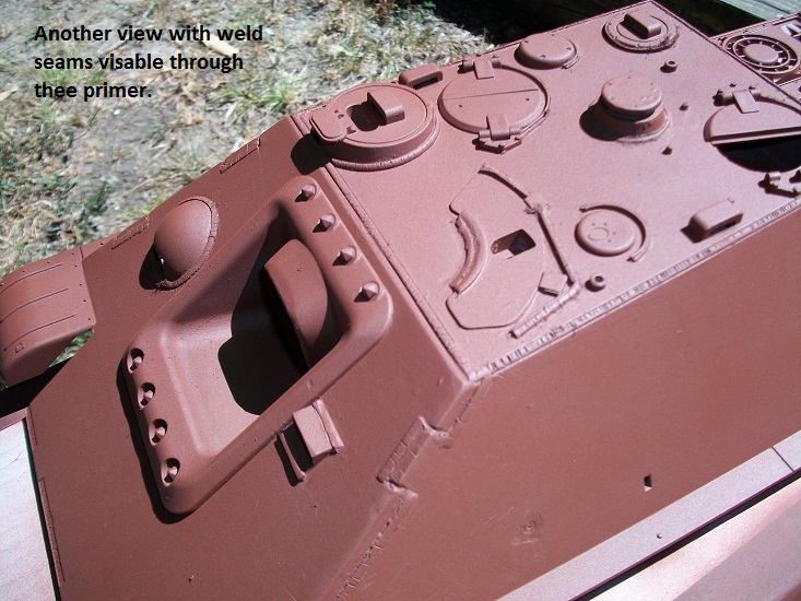

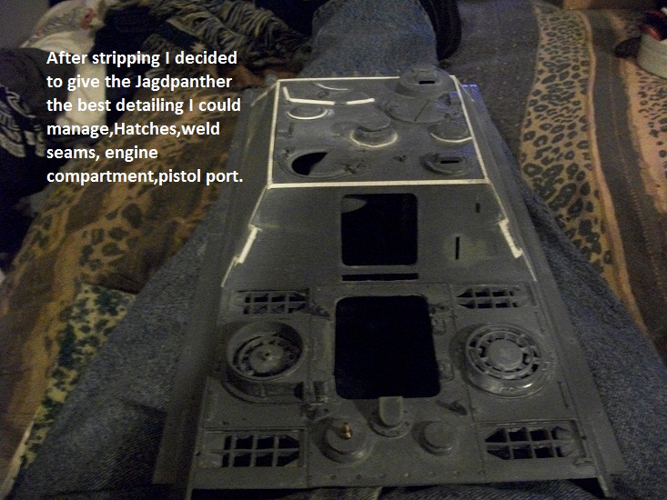

I used a different approach=http://www.rctankwarfare.co.uk/forums/v ... =22&t=6128 Evergreen 1/4 round and 1/2 round strips.Glued in place and cut using a hobby knife. Once painted the lines appear very clearly and as a continuous bead.The Link Has many more pictures,but here are a few.
This method was not mine originally yet I cannot recall the source.

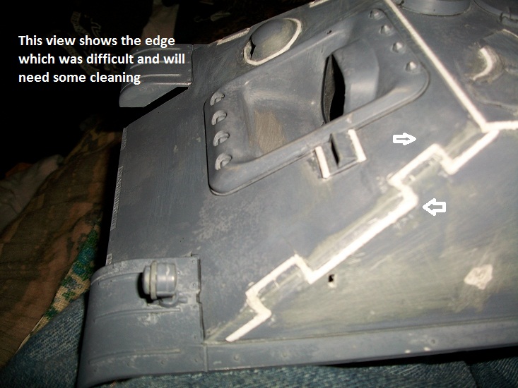

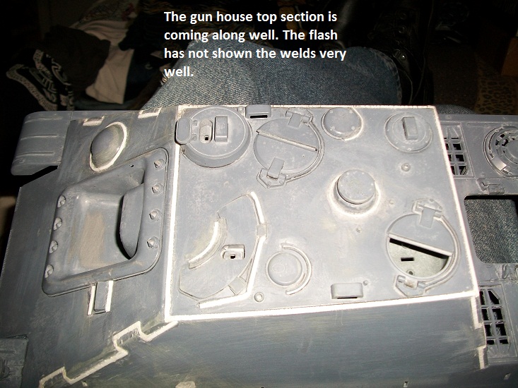

A super simple way is one of these http://www3.towerhobbies.com/cgi-bin/wt ... LXGGG7&P=K" onclick="window.open(this.href);return false; and squadron green (or white) putty. It is reuseable and can be used to do multiple tanks..
in the raw...
Some painted...
You simply fill it with a spot of putty and shoot it ..once dry scratch with a hobby knife. It's very accurate in tight spots
