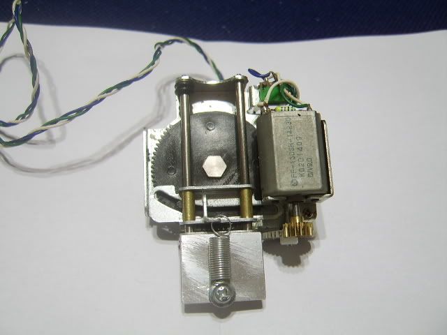

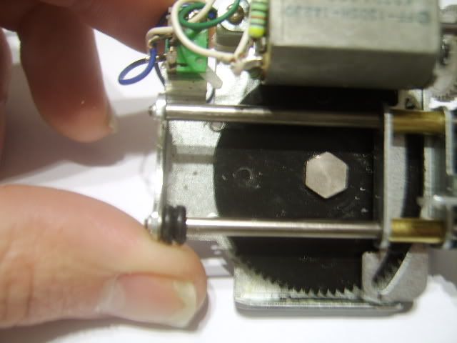

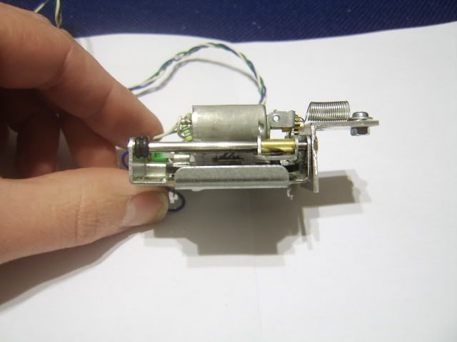

like this sax?

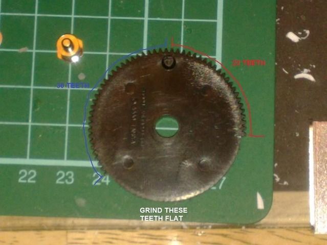

modified return wheel with the teeth ground off to give the snap
personally this one is system based if you are running H/Long straight id go for YHRs and 971wrights stug re-coil mod
dbc/H/long based id go with a servo recoill similar to nigels
tamiya based with the first ive described above :)

No nothing like that,that mod has been tried by many,my approach is completely different,and much more controlled with a much more realistic movement, I used video to time the move a developed a slide design that creates the motion, That mod you have works ok,but seems rather weak,does not really use a machined approach.

lol the only weak thing there is the plastic gear wheel which could be replaced with the wecohe brass wheel?
the sliders have been remade from brass tube and a spring added to snap back to position
yours does sound very interesting though mate ;)

There's nothing weak about te fileing teeth off method sax, both wecohe and impact use this and withs variable pot to tune the return speed the result is as accurate as it gets. Would like to see your mod though
