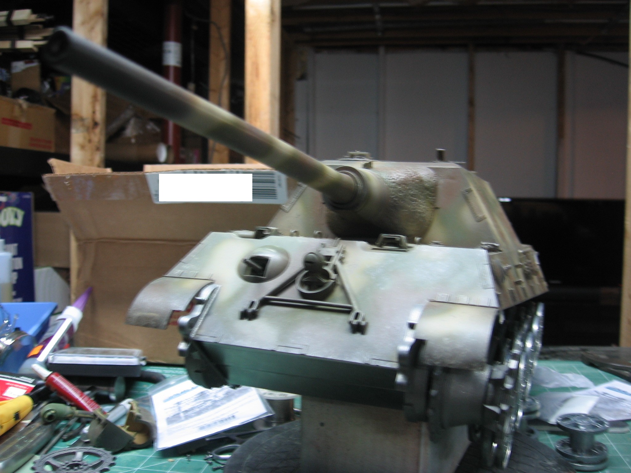

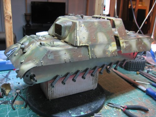

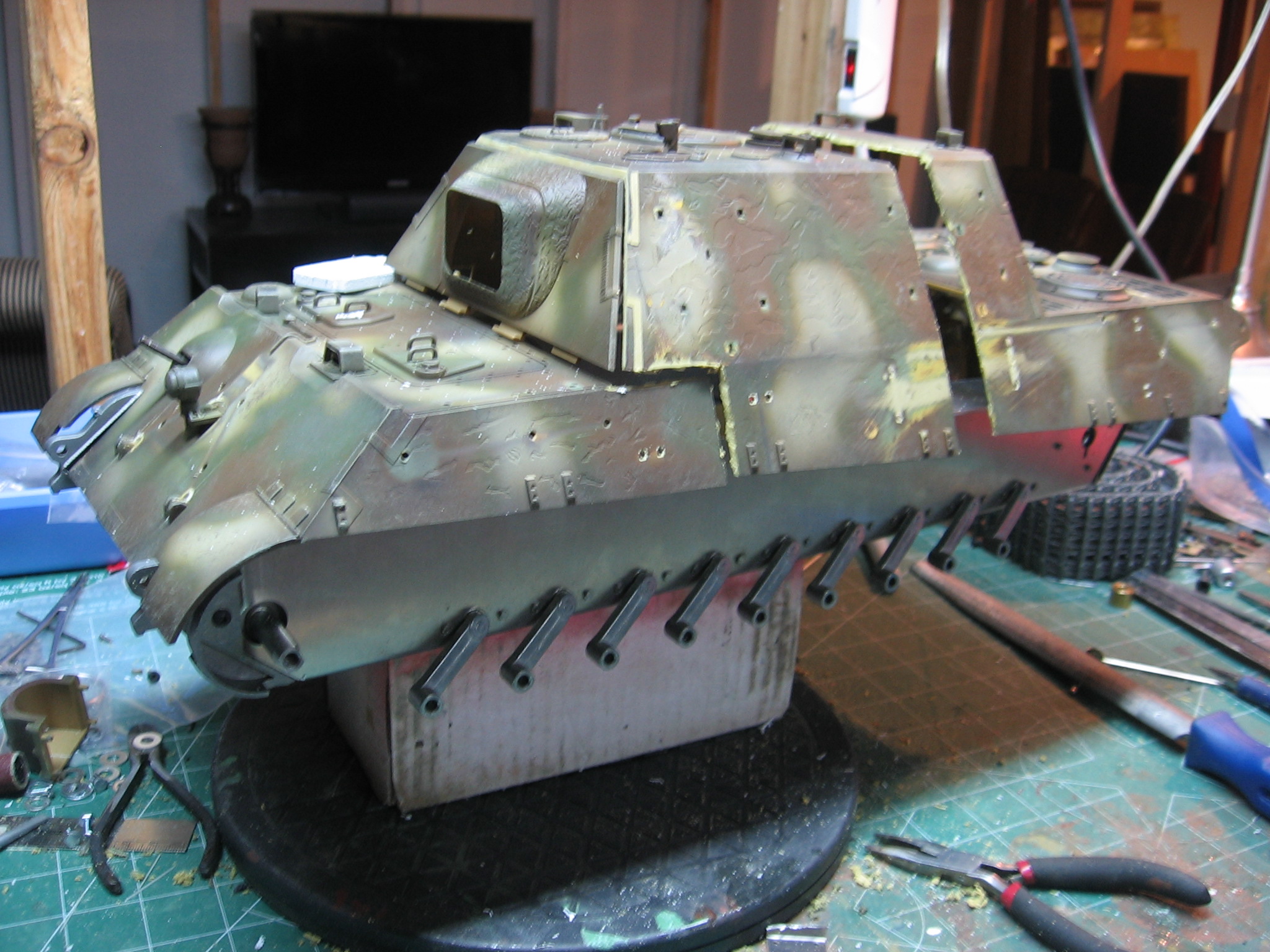

Well after a few months (5), I have been able to collect the parts necessary to start building this monster.
SPECIAL THANKS to ULI at wecohe, Steve at Welshdragon, and Jason's store in Japan, MITOSOL , and a guy in China(ebay) who got his hands on a MAtorro JT for me!!! Everyone was very fast at shipping and all parts made it to me OK except the original matooro tank. damaged in shipping (rear tensioner broken off) but does not matter as I am using :

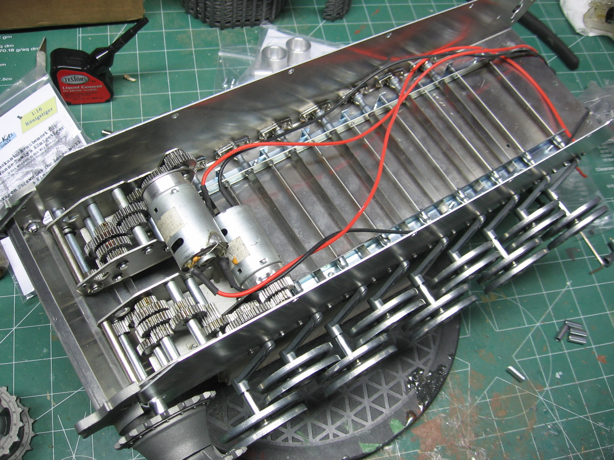

Impact gearboxes (MUCH better than last set)
Impact cast tracks (with 40 spare links..that is why I bought from Mitosol..you can by individual links)
Tamiya hull parts
WECOHE extended aluminum hull (asiatam?)
Matorro upper hull (to be extended)
Heng Long/asitam/wecohe electronics

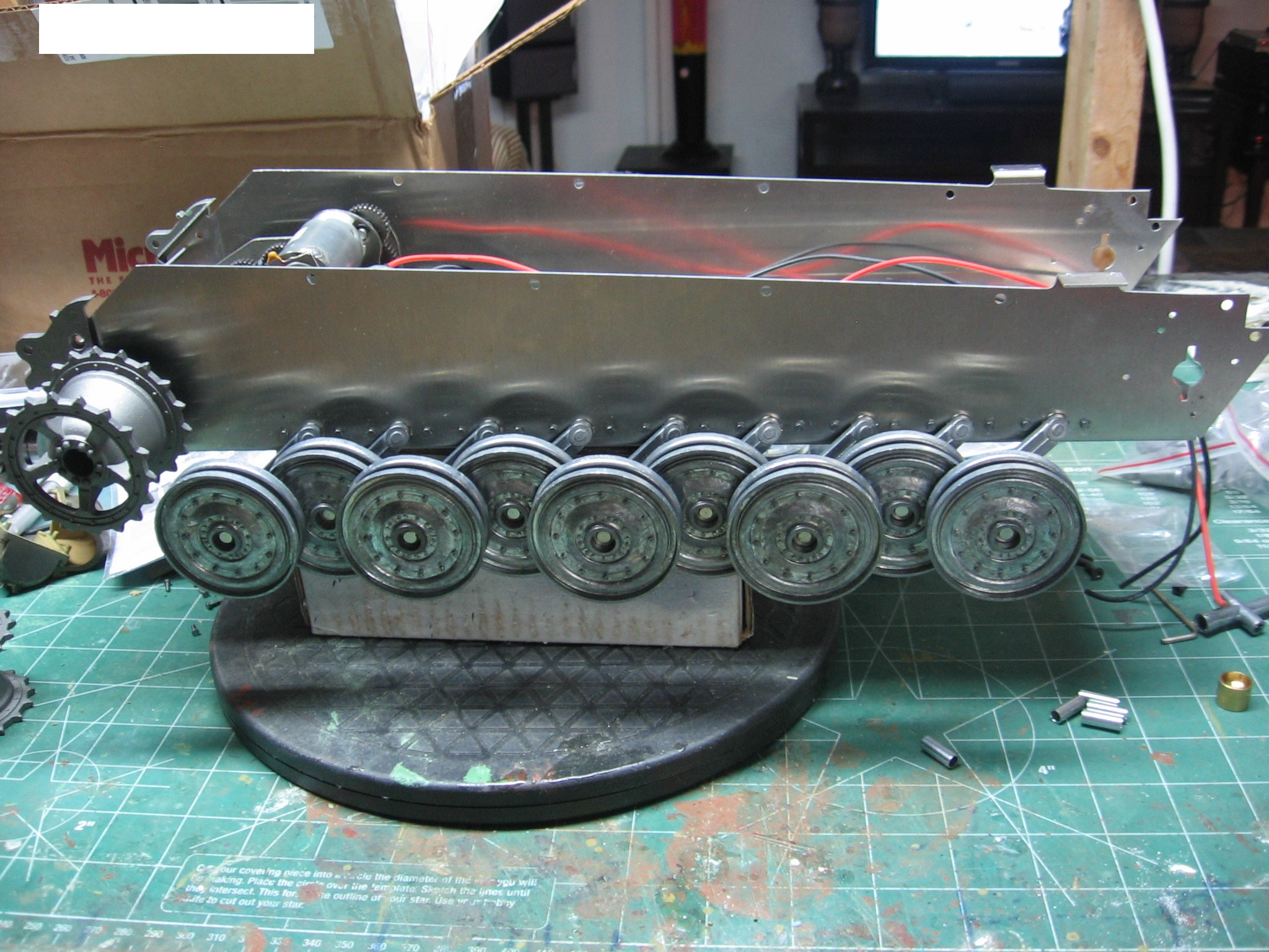

Asiatam metal wheels
A few asiatam hull decorations
Still need a few Tamiya bits and will get these from Tank Museum Store....more to come....

Thanks Freaky! Well, it will probably follow my KT kit bash build internally.........
this is the biggest and last in my series of 1/16 jagdtigers/panzer jager:
Nashorn
StUG III
Jagdpanzer IV
Jagdpanther
Elefant
Jagdtiger
Hetzer
kinda sums up the German effort from beginning to end...started small..ended small...and they make great models.
As far as finishing/theater...don;t know yet...not too many choices for the JT...
But I do know one thing, it will have the final type tracks/18 tooth drive sprockets....

Re: XRAD'S JAGDTIGER

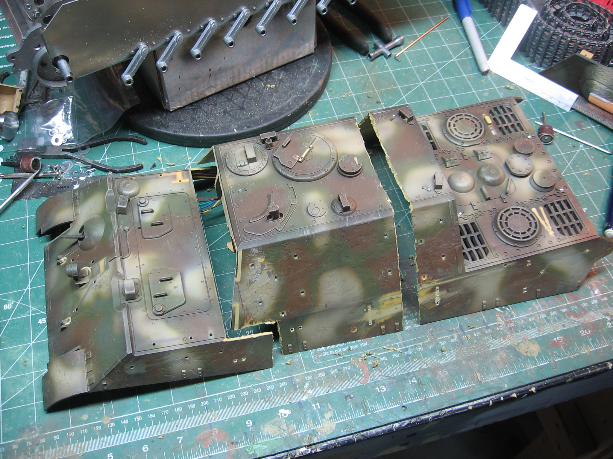

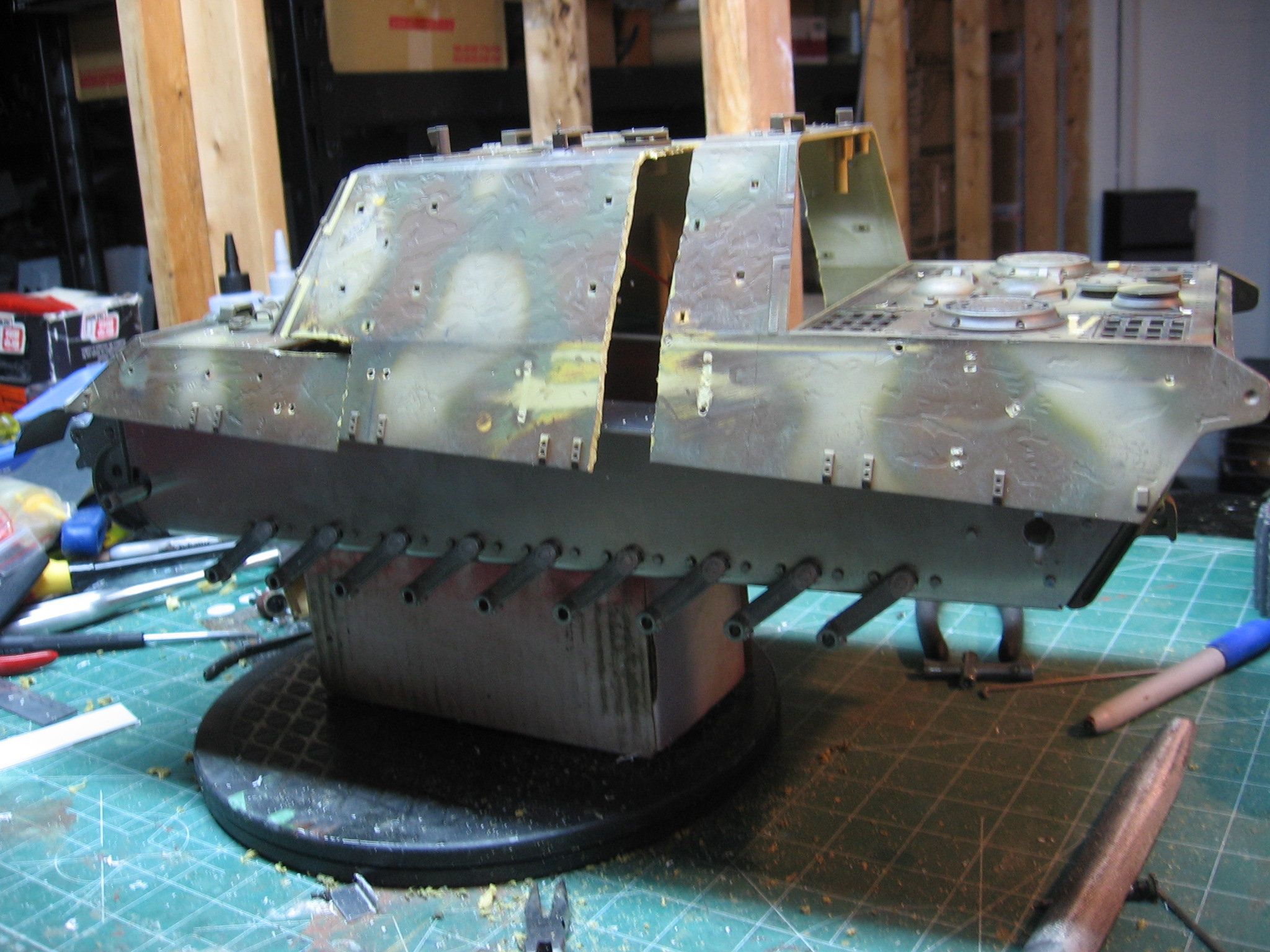

cuts for fitment.
Increase front plate angle
drop the front deck by just under 4mm (easier to raise the citadel and measures out pretty close anyway)
extend citadel (front deck and rear deck nearly scale, citadel vents and access ports slighty off...but I am not moving these)
Pretty close to scale...
