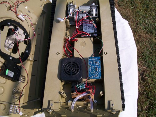

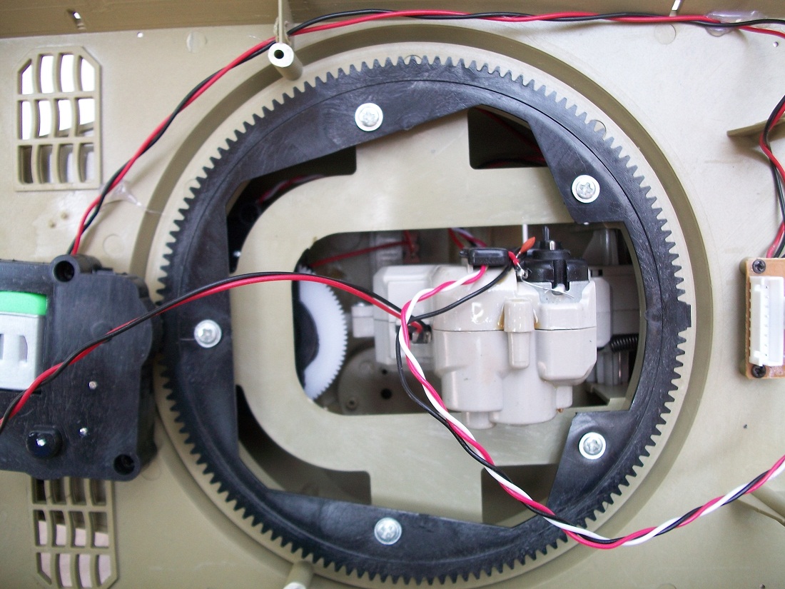

Jeff, Once you remove the 6 screws the hull lift off, be aware of the antennae wire connector, remove the 5 screws to begin the turret disassembly. I'm painting this tank so I have it completely disassembled now.These are older pictures of the basic disassembly.If you require more detailed photos of the disassembly of the lower end,tracks,wheels,gearbox,electronics let me know. Saxondog
Hull separation after the 6 screws are removed.

Remove the Ring gear to disassemble Turret
