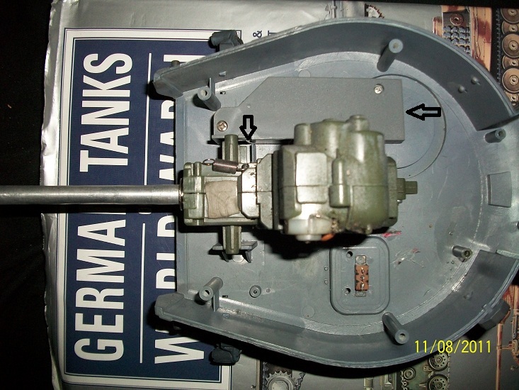

These pictures show a VS gun(same as HL) and the feed tray inside the turret. If you can hear the gun cycle and then a single "popping"noise the gun would seem to be working. This then indicates a jam in the feed tray. Turning the tank upside down and a sudden strike with a screw driver handle on the turret roof beside the copula may dislodge the jammed pellets.
Notice the arrows,the arrow pointing toward the gun,this is the pellet Shute and where the jam occurs. the other arrow points to the tray under the copula where you add ammo.
HL Tiger feed tray and gun mount
