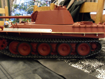

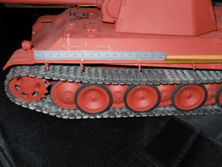

All I'm saying is the set is older,it may work for your build. Check out the Master Class section Build Panther II.
Nics Panther II.jpg (81.44 KiB) Viewed 452 times
Nics Panther I.jpg (70.28 KiB) Viewed 452 times
