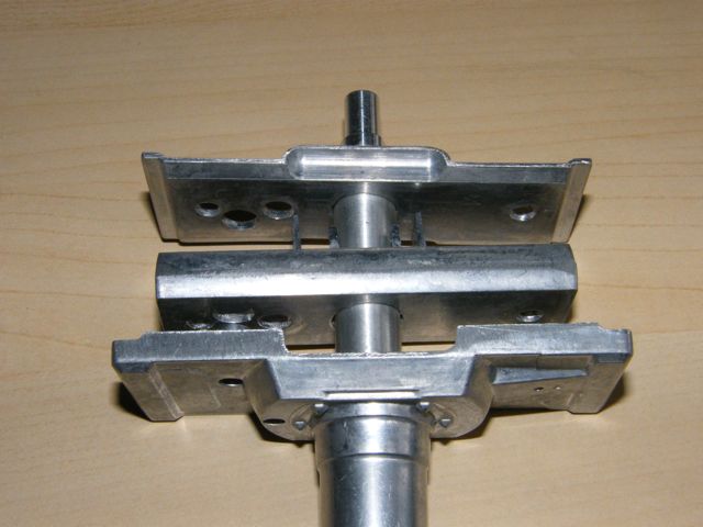

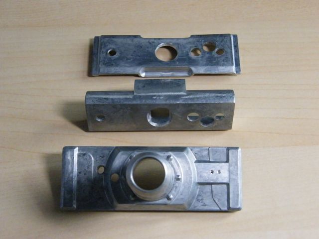

Hi Tankbear, I can recommend the metal mantlet, my Tiger I has an Asiatam metal barrel and a metal mantlet, I had to drill out the three sections of the mantlet for the barrel to pass through, I also had to drill out the two scope holes on the left side of the mantlet and the machine gun hole on the right side. All worth it to add more metal to the tank though.
