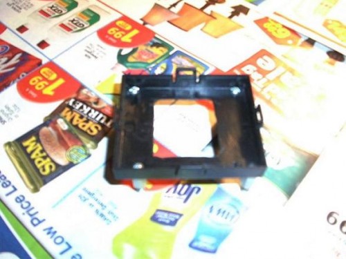

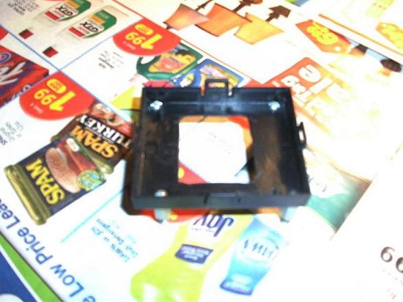

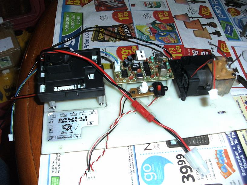

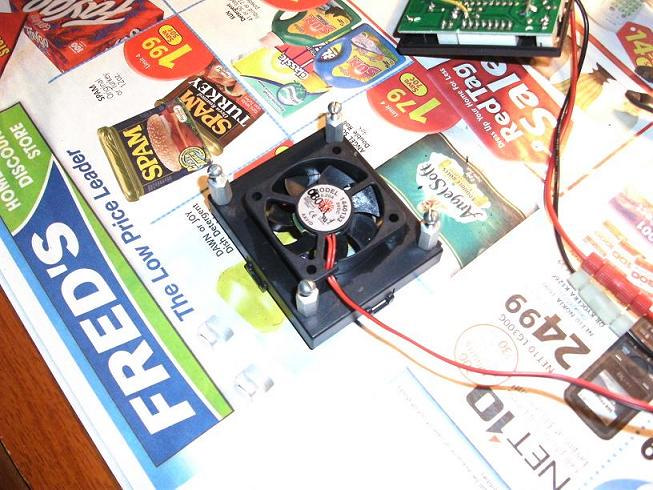

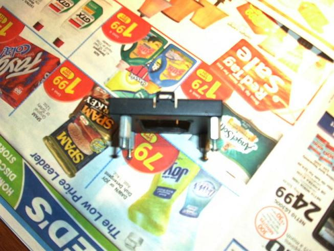

Re: Anti Track recoil / Jerk
Elevation and fan cooling the RX18 Unit. The nuts could also be used to double stack units? Just a thought?
