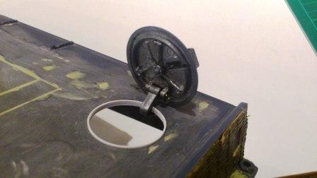

I had to wonder long and hard before opening up the front hatches on my Heng Long Tiger 1. Should I use some of circular saw? Or a compass-like cutting tool with a blade attachment?
In the end I went for my trusty Maplins Rotary Tool (http://www.maplin.co.uk/18v-rotary-tool ... set-223458" onclick="window.open(this.href);return false;) - and a bit of elbow grease.
First I just drilled a hole through the centre of each hatch - then used the rotary sanding attachment to enlarge the hole gradually using the original hatch as my outer limit (the aperture should obviously be slightly smaller than the hatch circumference).
Replacement hatches are readily available - either with or without the internal levers. They actually clip on the underside of the hull roof (the HL Tiger already has two fixing studs on either side) although be warned - my first set of hinges both sheered off with minimal pressure applied (possibly a fault in the metal).
Driver's hatch opened up with Asiatam cover.jpg (15.57 KiB) Viewed 4854 times
Last edited by tanks_for_the_memory on Wed Oct 26, 2011 2:37 pm, edited 1 time in total.
