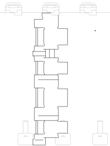

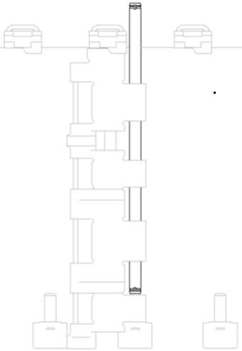

Hello Phil,
I think that you may have misunderstood how the hangers actually work, I know that I did.... :haha: ...they do seem to be a bit odd at first, here are 2 pictures of the correct way to hang the tracks in the 'Holders' ........... Note that the top and the bottom hangers are 'Staggered' to fit the links AND to still allow the track pin to be stored WITH the track link , as per the second line drawing !!! .....or to put it another way the hangers support different vertical parts on each track link.
>>>>>>>>PLEASE NOTE THAT I THINK YOU HAVE TO CLICK ON THE IMAGE TO SEE THE LOWER ATTACHMENT PIONT IN THE IMAGES <<<<<<<<<<.....at least I did when I previewed
I hope that this clarifies the correct way to mount the tracks with the pins......as I said it does seem odd, but once you 'get the idea' it works well.
I think the the line drawings are by a David ..... Someone so credit for them goes to him they are NOT my creation....I just found them on the web.
Alb.

The line drawings are correct but i think the point made by the original post is that the top hinged section is cast in a downward slope, (closed), position. In the drawings they are almost straight. I have these on my 1/16 tiger. Yes they do push the track links into a lower position on the turret and somtimes snag along the tow cable bracket. Overall they are not bad though and detail is good. Do not know if thete are any better at this price.

Also agree with Saxondog's comment re lack of hole in top of links but they are just standard links from a metal track set so i think they are just leaving yhat up to yhe customer. Picture is also spot on with regards to placemrnt of bottom mount. I think most people would assume bottom bracket was directly below the top in a straight line
