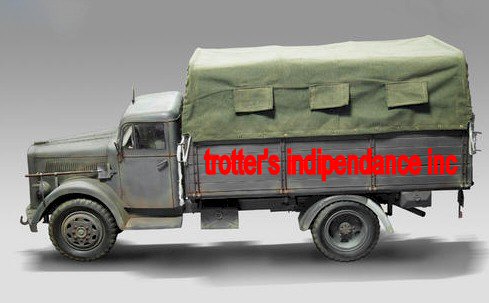

well that i would like to see but theres one little problem i dont think the three wheeler was around in the ww2 the regal was a british built car but then again there might have been a german decendent of the trotters at that time and he might have had one of these
cheers Derek

just a bit of fun and i know the spellings wrong was quickly made up
cheers Derek
