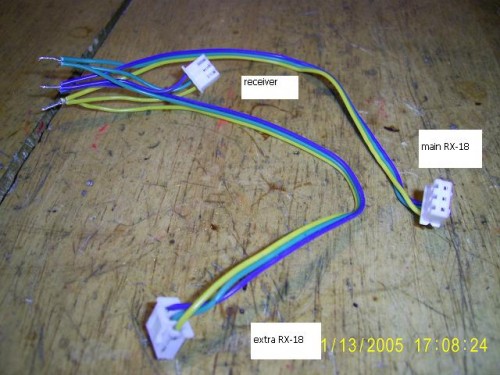

The mod is quite simple : I just use an extra RX-18 board hooked-up to the power supply and the receiver signal ; to power the main motors only ...( I also send a signal to my smoke unit )...
This configuration not only disable the tracks recoil on the main motors ; but it also allows me to fire the main gun on the move ...

Very interesting, looks good on the video. Can you post some pictures & diagram of the extra board and wiring set up.

There you go ...
Good luck !!!
Norm.

Norm, Are you using two RX18 in your modification?

Yes I am ...
The main board is a new RX-18 and the extra board is an RX-18 with a blown sound card ( but the motor drive section is still working ) ...So i'm kind of recycling at the same time ...
As you know , it's the sound of the gun that triggers the tracks recoil on the RX-18 ...
I'm using the upper left control to trigger the recoil and the sound of the gun as per the mod. on the old RC Command site ...But since this is hooked -up only on the main board ; the extra board doesn't receive that trigger signal and therefore it doesn't affect the motors ....Don't know why nobody has tough of that before .?????

For those among you who don't like the idea of welding wires between the 2 RX-18 boards ; Just use 2 "receiver main board " harnesses and splice them together ...

Rite going to be thick now from as far as I understand you connect the extra board in and don't use it just ignore it and have your bits plugged in as normal am I correct in thinking this

The only things you connect to the extra board are the main motors ( Right & left )...
