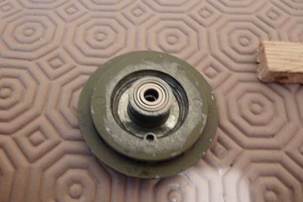

Thanks ice, hears a pic of the bearing pressed in place i fogot to add
bearing pressed in
bearing pressed in
