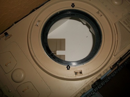

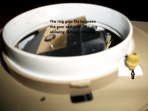

These two pictures show the ring gear installed in a King Tiger,the problem is the fit must be tight and the turret has added weight to prevent the turret from jumping out of the hull. Mine works very well and is fitted with less than a mm of play between the guide rail and the turret ring.

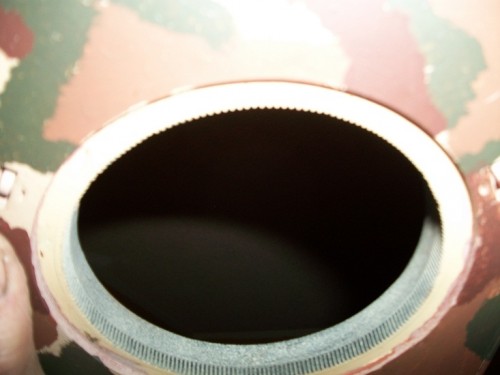

The next series is the Panzer IV Ring Gear and it is in my Porsche King Tiger but the lower hull is the same.

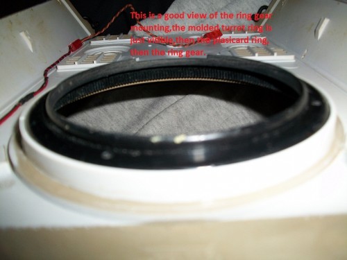

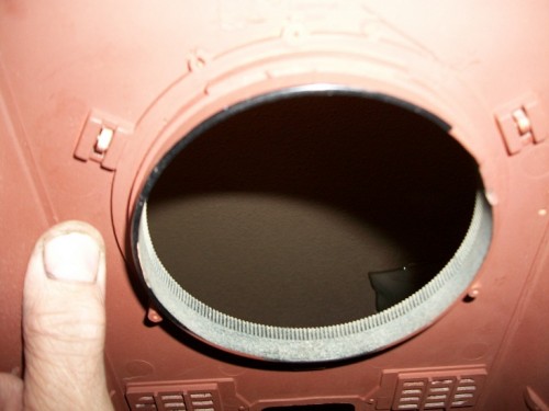

This mod can work but is difficult to build,another member tried and was nothing but a headache. This picture shows the guide ring,this ring is a tight fit to keep the turret from crawling out when the gear drive for rotation is in motion.
If the guide is not tight the turret will crawl out,of bounce out as well.
