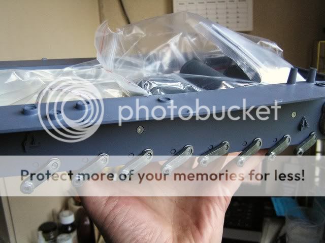

      - Doesn't work like that . - need the proper receiver, and tranny too . Rats . - This was going to be more exspensive than i thought . Ah well , at this time i'd noticed that the Asiatam hull was on offer , in for a penny . . .
      • Image
. . . there's plenty to play with . . .

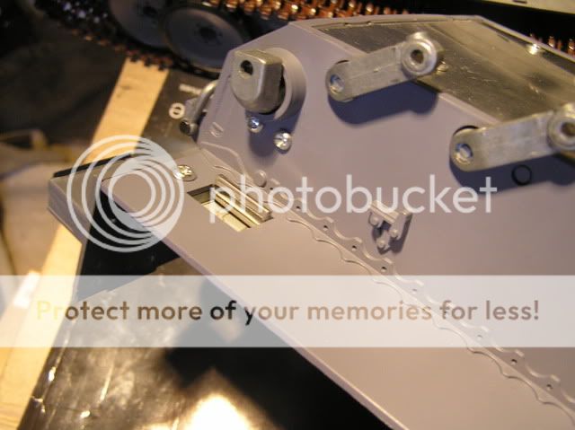

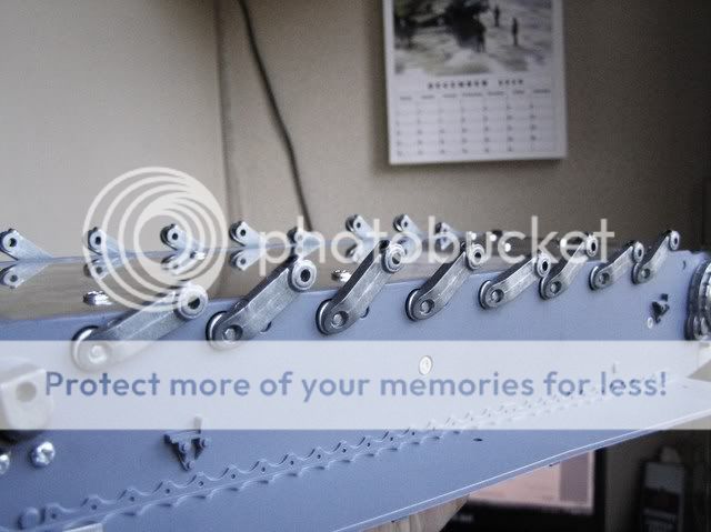

  • A couple of things caught my eye , the suspension was a bit squiffy . I proceeded to disassemle it , thinking that by rearranging all the torsion bars , collars et al would make it better ( i also teased some '0' rings into the axle holes in a vain attempt at waterproofing ) Nope , what a waste of time , still all a'cock , eventually i got them just so . - by brute force ! twisting the arms against the springs until they were where they were meant to be . :(
Obviously this is how they did it in the factory . which explained why some of the couplings and springs were 'wrong' to start with .

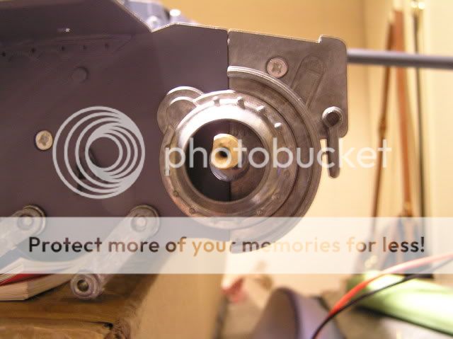

  • Fitting the gearboxes . . .
Image . . Lesson 2 , Mato 'boxes are cr%p . they aren't a 'drop in' fit for a start . O.K. i half exspected that , no problem really , just a few extra holes to drill and screws/nuts . but worse was to come .Don't be fooled by this photo , this was taken later . . . the left hand 'box went in painlessly but the drive shaft on the right hand one was so far on the p*ss it would wreck the tracks + wheels . At this point i thought i'd got a rogue one , so i returned it asking for a replacement . SAME THING ! - I tried another supplier - Ditto . Checking online i found it was not just a bad coincidence , more curses . Botch time . . .
  • Image
. . . I removed the final drive axles , and putting a 5mm round bar ( a welding rod just happens to fit :shh: ) through them showed the r/h one would line up , but needs some kind of spacing underneath . Cling flim was placed over the base plate and a largish blob of Araldite splodged on , then i quickly assembled it again - with just one screw to locate it , the rod kept it alinged until it set . afterwards i took it apart , removed the clingfilm , and drilled the necessary fixing holes . Yay !

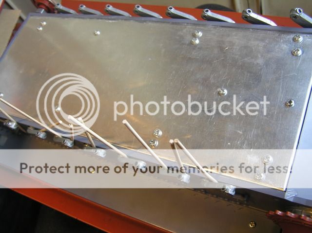

  • . . . . Another thing with the hull , holding it up to the light shows gaps . loads of 'em . Now i don't expect to go bathing with it , but damp grass and the occasional muddy patch are asking for problems with moisture creeping in and causing corrosion , plus the electrics arn't keen on the stuff .
Sooo , here you see me running some superglue along the seams , good 'ol cocktail sticks make neat little wedges holding the edges nice and snug while it sets . I will take out the underbelly screws , one at a time , countersinking the holes and replacing them with c'sunk ones , a touch of loctite will keep them tight . then i can put a thin sheet of styrene over the whole lot , a little silicon in the centre area and plastic glue around the edges . Touch wood it will prevent the joints coming apart again , anyway it tidies the bottom up if nothing else .
  • Image

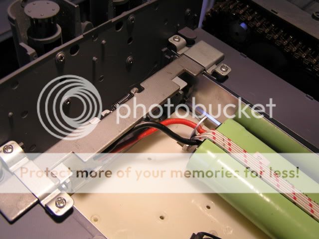

This is the Q.D. catch / cum rear hull bracing strip - Top
  • Image

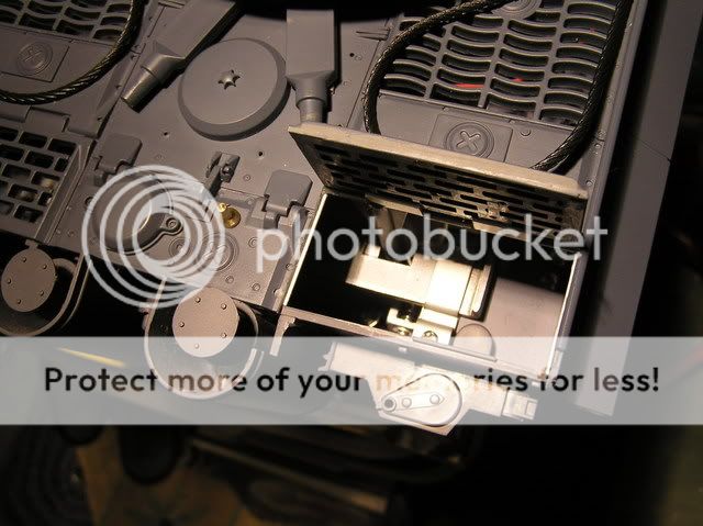

    • . . . and here , under the l/h pannier above the idler wheel - where the you are supposed to just give it a little pull and the upper hull can be lifted off .
    Problem - unless you have minature fingers or carry a crochet hook thingy , how are you going to get to it ? - plus , when the tracks throw crud , where is the muddiest place going to be . . . yup .
    • Solution , blank the hole off and flip / reverse / reassemble the bits , and . . .
    Image . . . 'bout that eh ? - and there's even room for an on/off switch /charger jack . (just :D ) . . . Well that's enough for tonight . Stay tuned for the next exciting episode . Coming to your monitor soon - Pt 3 . OMG ! IT'S . . . IT''S . . . . THE WHEELS !
