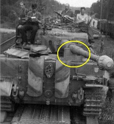

You have another choice , a wooden block as on this late tiger1, also on 205 I have a picture of her with what appears to be a wooden block for a gun crutch ,on her way to the Normandy front in 1944,............

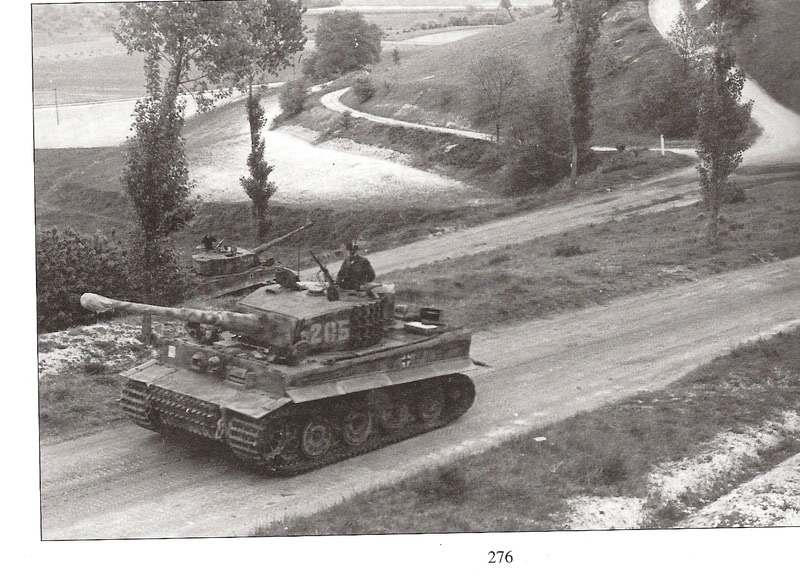

I like that wooden block idea. Do you have that picture of 205?

the wooden block was for rail transport only,as was the factory travel lock afaik,I have no idea why it was introduced and then dropped,I believe there was an internal travel lock in turret,maybe it fouled Traverse when gun was depressed ? I read somewhere that it was offset to the right because tunnels curved mostly to the right in europe,I've got said pic of 205 somewhere I cant remember if lock was on left or right,its shown upright I think it didnt pivot,why not put it in centre then?mystery,I know that the Tamiya 1/35 mid production Tiger kit has one,it looks a lot different to Panthers lock,hope this helps

If you look closely it can been seen on the rear deck,...........

Re: Late Tiger 1 gun travel lock
well spotted on 205,these wooden blocks may have been issued on Tigers when the travel lock was discontinued,I think the Tiger on the train is from ss 102/502 abt,the light coloured shield would have a dark pink lightning flash unit badge if I'm right,these tanks had a neat broad banded wavy camo pattern running horizontaly along the sides in brown and green with narrow wavy lines in dark yellow and staggered turret numbers very different 102 abt tanks stand out among other units the all seemed to have this camo,my choice if I do a late Tiger which I feel coming on now
