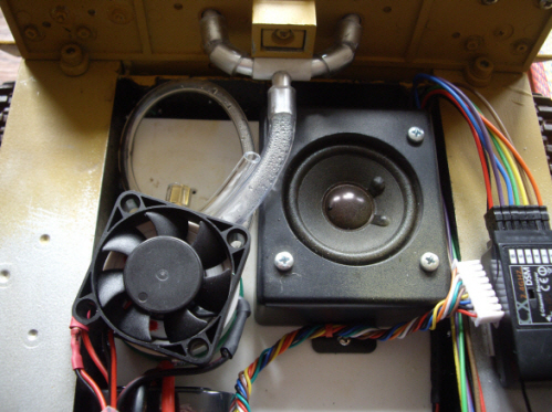

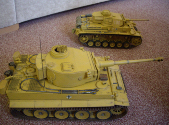

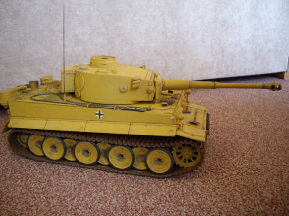

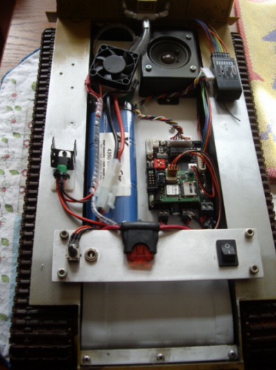

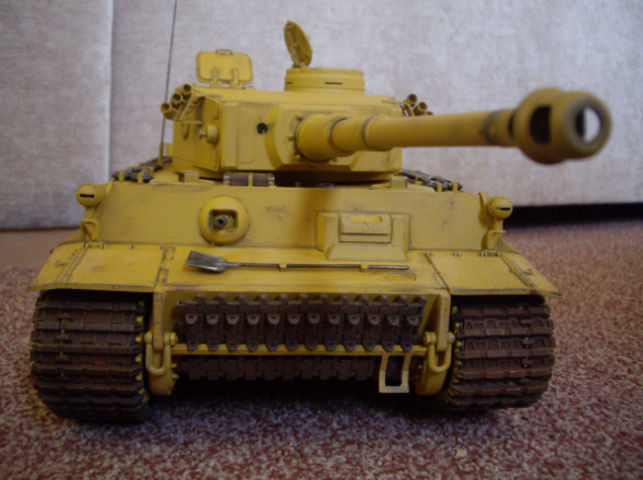

A sneak preview of my Tiger, a work in progress. It has had alot of mods inc the painstaking turret re-align. I'm really happy so far except for its heart, she is still empty as I have had so much trouble with the elmod setup. I just can't get it to work!
Still a few cosmetic details to add, rear air cleaner hoses and front hull vent. Have decided not to mess with the rear turret bin.
Can't decide on a turret number, I know there were some Tigers in Afrika without so I may leave it.
Hope you enjoy, more to follow....

looking nice,
ice
Gunshy
Posts: 122
Joined: Thu Dec 09, 2010 4:21 pm
Location: Scotland
Re: Mic's Early DAK Tiger 1
Post by Gunshy »
Wow, excellent. Cracking shade of yellow. Looks great with the Pz III.
:clap:
Hope you get the elmod working. I've not got as far as that.

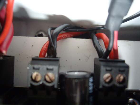

All working now! will post video soon.

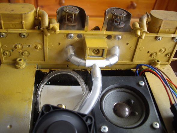

Hard to capture smoke

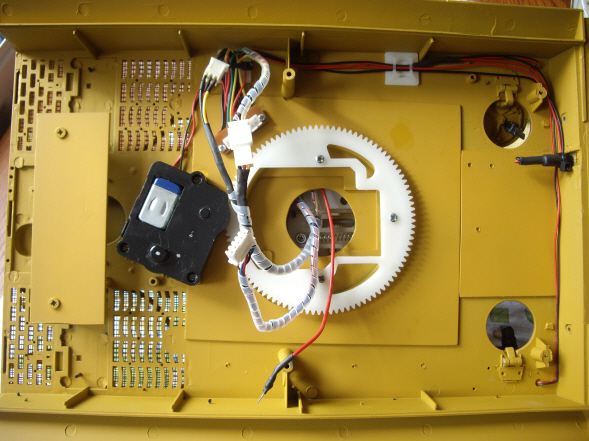

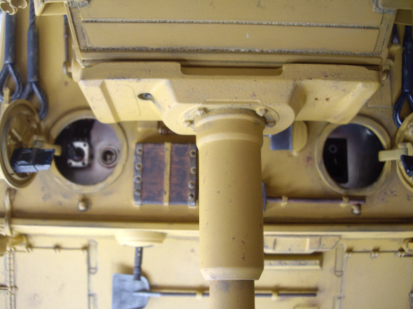

Turret centralised and moved back
Smoker wires on RH motor and fan neg wire on LH motor
I cut the neg wire to fan and connected it to motor

subtle shading,good tone,if you do want to number your Tiger there were about 11 of your type ie standard front mudguards,they all served in 504 abt they carried a rhombus white with red stripe tactical mark as well as tiger symbol,small balkenkreuz and solid red numbers 1st komp only afaik,the other tanks in said unit were older and transfered from 501 abt and seem to have kept numbers they were given while seconded to 10 pz div, 7-8 komp large numbers white outline red infill before that they had large no's 1-2 komp and were painted grey green RAL 7008 over the top of dk yellow leaving yellow infill they had larger crosses,the most suitable numbers for your type are 112,131,142,there are known photos of these,other pics dont show the numbers,they are solid red and rather small (about 30% height of turret)and placed in near centre,pics of bovington Tiger 131 pre restoration are best ref for all markings for 504 abt so any number you like starting with 1 is possible but there was only about 11-12 (4 platoons of 3 each?)of your type that might help you figure it out.altogether 501 and 504 destroyed 300 allied tanks,only 30 odd Tigers were sent to Africa nearly half lost in combat and 20 odd destroyed by own crews

Excellent, just a fine example of that group of German Armor that was wasted through lack of material support. The smoker is a unit you have built or purchased? Saxondog

Looking good. I like your painting and weathering.

I wanted to ask you about your pz III heng long?what did you do with it,any mods,improvements,I fancy one but would'nt know where to start,can you give me some idea's?
