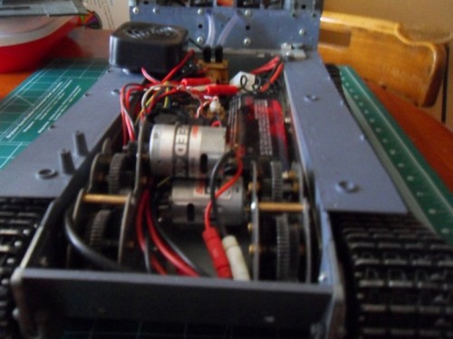

I recently got a HL Panther G with metal tracks, gears and sprockets. I ran it for about an hour on a hardwood and laminate floor before painting it.
I put it back together the other day (I never removed the gearbox, just taped it up to avoid paint/varnish) and ran it for about 10 minutes on a stone floor in my kitchen, when the right side track stopped rotating but the motor was clearly still running.
I lifted off the top and ran it and found the last two gears had stripped. The axles holding the gears look slightly out of alignment which probably speeded up the stripping.

Don't waste time with the stock boxes, the 'metal' gears a just soft white metal and hardly better than nylon gears.
The Asiatam boxes are well worth the cost and miles better, and even worth a bit of fiddling, though they should go in OK.

Really the plastic gears are not that bad. Your other options for this tank is there is a steel geared version available that uses the same box so no fitting issues (if any) to worry about. Regarding replacement gears, you might be able to find generic gears that fit that box but it will probably be easier to replace the whole box.
An economy option would be to see if anyone has plastic gears available for you to use in the meantime.

I contacted Forgebear and he was extremely helpful and sent me a replacement gear box for a bargain.
Definately appreciated and can't recommend more. I figure one day I'll get a dramel and tapping tool and replace them with the Asiatam boxes when these wear out.
