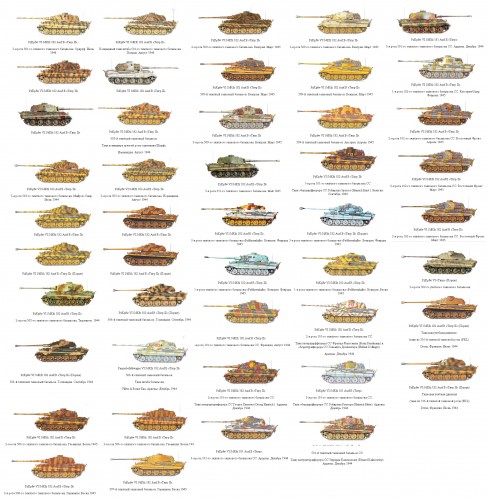

Dan this might help some,this is going to the ex stream.
http://forum.worldoftanks.com/index.php ... e-project/" onclick="window.open(this.href);return false;
King Tigers Paintwork

Thanks for the reference pics. I like the one that looks like a shabby attempt to coat the whole tank (#4, top row)...
I whitewashed the whole tank last night. Will take pics outside later today when it warms up a bit - it's -15F here now and lots of snow - like Russia.
