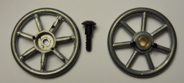

nicktank
Posts: 29
Joined: Mon Dec 13, 2010 12:02 pm
Re: asiatam track tensioner HL PzIV
Post by nicktank »
xrad wrote:I never used the Matto idler...but post some pics so I can see...it can't be too hard...maybe a bolt or two and some spacers..
Is it BB or just brass bushed?
Show the axles , too.
Will do, it's at my parents with the rest of the project, out of my wife's way lol looks like a metal version of the HL plastic ones, not BB, brass bushed I recall I think. will get a pic for you, thanks
nick

nicktank
Posts: 29
Post by nicktank »
hi, finally got around to photo them, here it is...
idler
idler
fleshpedler
Posts: 664
Joined: Mon Sep 15, 2008 1:36 am
Location: weston super mare
Post by fleshpedler »
They look nice Nic, only trouble I had was the asaitam ones, that I had,, the middle brass was to short so had to make them longer for the metal idlers ,and went and broke one ...what a dimbat 8O I feel now,......all that work and screwup on a simple thing like that!,.................just goes to show anything can and does happen,. :'( ..................
