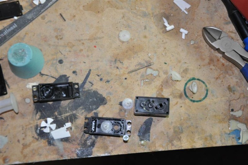

Heres how you do it. Go buy a cheap 10 servo or use an old one, perhaps one with stripped gears.
Next remove the screws from the bottom and pull the thing apart. You should end up with a bunch of little plastic gears and a motor attached to a board with a pot attached to it.

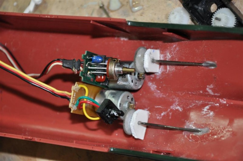

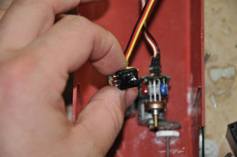

Believe it or not you are almost done. From here you can desolder the motors from the board and add leads or even replace it with a small 6v motor of your choice. Dont go to big or you will melt the little esc for the servo. They are not that big. Next plug the servo into a rx with a radio and make sure all the trims are centered.
Now adjust the pot until the motor stops spinning and glue it in place.
Thats it your done. And they can be used for lots of thing radar masts, drive motors etc. The best part is it comes with gears to make a reduction out of them.
I am using 2 in a little 1/200 tug boat I am building and they work great! All you need a rx battery and it runs great!

Aha, now I see what you have done, that's a nice way to control motors. I might try and do this with the radar on my Perkasa when I get a spare moment.
Thanks for posting the pics, much appreciated.

They work very good for radars and the such. You can also desolder the motor from the board and add your own leads so you dont have such an odd shaped piece to mount.

It also includes how to eliminate the pot
http://roguesubworks.com/downloads/servo-mod.pdf" onclick="window.open(this.href);return false;

you can replace the pot with some resistors and adjust it with various ohms. I read a thread on the subject a while back on RC Groups. When I find the link or specs I'll post them.
Re: How to turn a servo into a motor
I already have those specs included in the downloadable file if you like.
