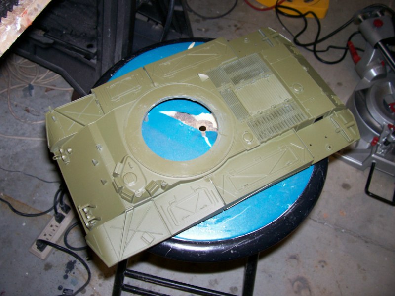

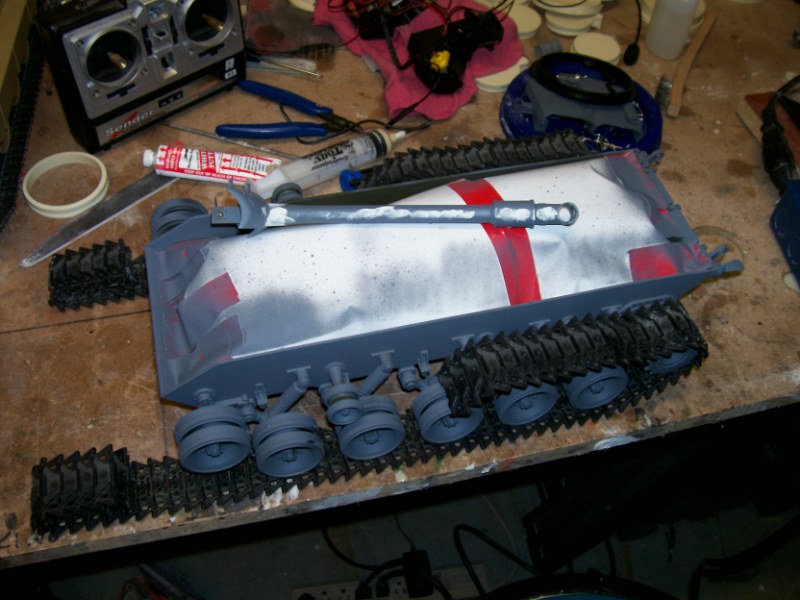

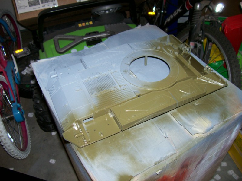

Ok I braved the fumes and took a few pictures. Nothing to really look at yet but the paint definitely looks better then it did before. It doesn't feel so PLASTIC now. Filling in all the seams on the gun barrel will be nice as well.
I also used the back edge of an xacto blade to open up all the vents that weren't from the factory (hard to see in a photo graph.

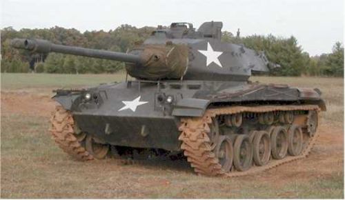

Here is a look at my goal for this tank

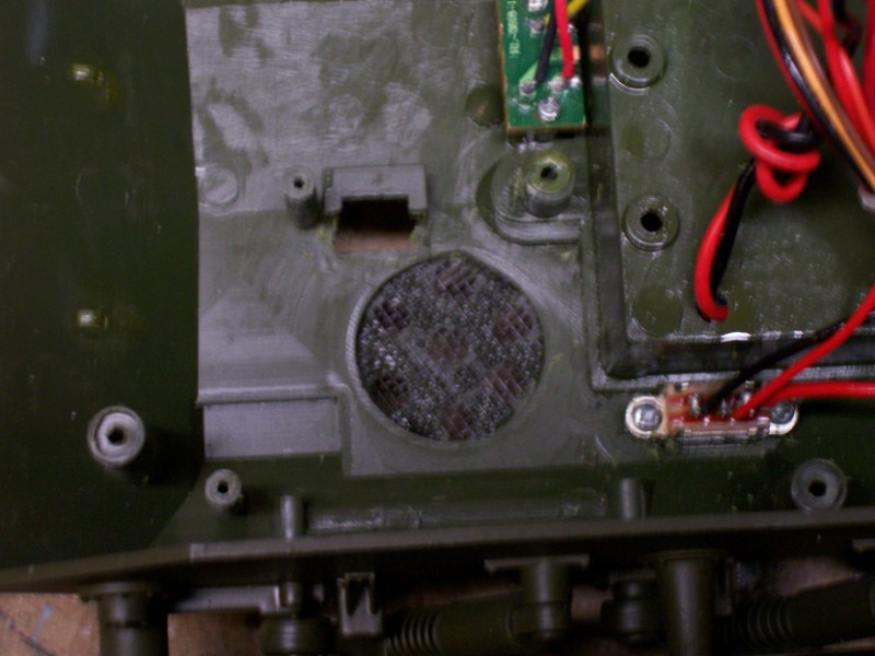

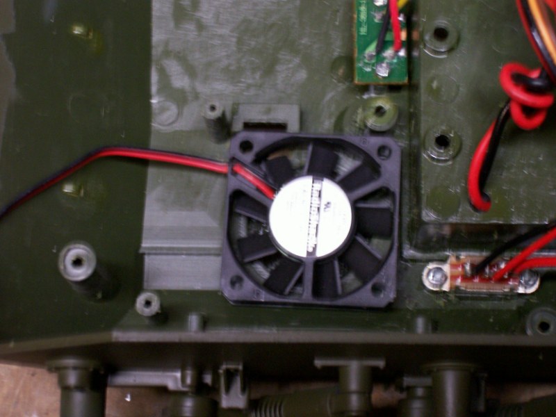

So one thing I noticed while pulling this tank apart is just how crappy the wiring is laid out and how poor the solder joints are.. It is a wonder my tank didnt stop working before. Put this together with the complete lack of any kind of color coding and it can be a nightmare. I had no less then 5 solder connection break during my over haul. It took me 2 hours of testing to figure out where the wires were supposed to go and then replace and resolder the connections...God bless tamiya for clean wiring.
With that out of the way I set out to add my fan cooling. I wanted to locate it so that there would be a faily clear flow path across the FETs and at the same time limt dust intake while providing fresh air. I chose to install my fan directly under the ESC to ensure maximum cooling but there was no place for the fan to exhaust so I drilled 7 holes and covered the holes with plastic screening. I also had to use my dremel to cut out a mounting post and trim back the access hatch for smoker switch. With this setup the air should draw in through the vents in the back, across the engines (bonus), over the ESC, and out the bottom of the tank.
I then wired the fan to the smoke generators connection as I am no longer going to use that unit (its a piece of junk anyway and way to noisy)
