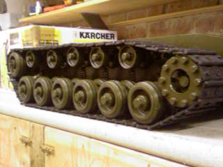

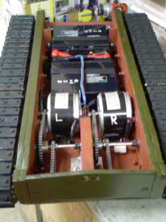

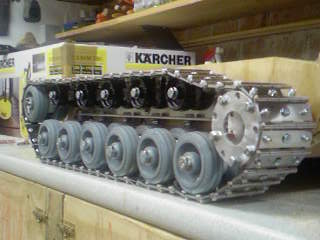

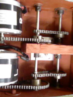

Hi
Here are some older pictures of my 1/8th M26. I have redesigned the back end and added a smoker since. I am also redesigning the final drive train (Tracks and sprockets) to use bycycle chain and Sturmey Archer 20 Tooth (86mm Dia) sprockets. This should give a smoother drive and stop the road wheels from rubbing against the suspension springs.

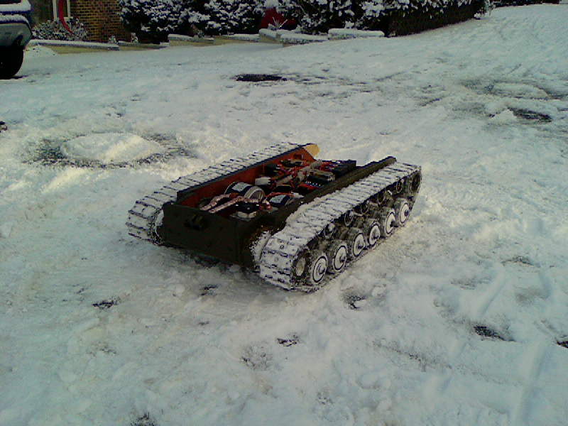

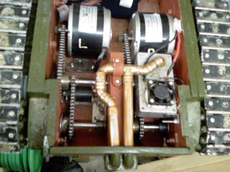

Here are a few more pictures of my M26 out in the snow yesterday. I have only made the chassis as shown so far. The 12V smoker is made by wrapping a piece of nichrome wire around a piece of fire rope. (For AGA door seals etc). The rope acts as a wick. Then the smoke gets blown out through the exhaust by a 40mm computer fan. It is wired to the control board that I made so that it operates when I move the tank in any direction.
Hopefully, I will be an asset to the forum, Thanks Gerwyn.
Phil

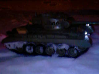

This is a picture of my Heng Long M26 out in the snow last January. Sorry it is a bit dark.

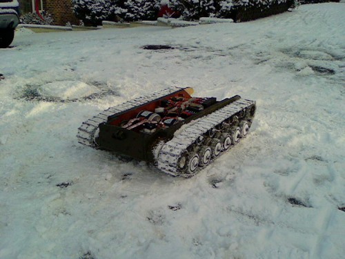

A brief stop for a photo opportunity. She was rolling through the snow with no trouble at all. The circle in the snow just above her, was made when I did several neutral turns in succession, OK! I was showing off to my 2 boys!!

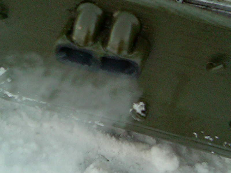

This one shows the smoke exiting the exhaust. Yes that is 15mm pipe elbows moulded into the twin outlets.
This picture shows my homemade 12V smoker using a piece of nichrome wire and a 40mm computer fan. The smoke fluid is fog fluid as used by DJ's etc. £15 for 5 litres.
