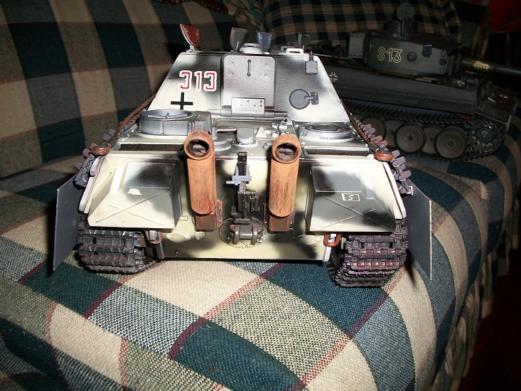

I used several tools, too apply a darker amount I would use a q-tip, for overall weathering a soft but large paintbrush. On the exhuast guards like the picture showing one with the rust color rubbed into the plastic. But the plastic was lightly sanded,all up and down creating grooves and feathering the plastic so the dust would grip in the grooves.
Then a very light mist of floor polish, if you spray to heavy it will run creating dark lines.then after drying a single light coat of the varnish,just to dull the shine some what. Now on the Jagdpanther I chose to wipe with a paper towel Plastistruct liquid glue on the exhuast round guards,then spinkle the dust on while the glue was wet,After it dries I rubbed more dust onto the exhuast again. But this time I did not spray the floor polish,just let the glue bond it to the pipes.
TIGER EXHAUST GUARDS
Exhuast guards weathering with pastel dust.jpg (50.93 KiB) Viewed 3952 times
Jagdpanther EXHAUST GUARDS
