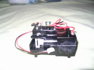

I mean the ones that have the power transistor on the small circuit board mounted on the unit. I need the diagram because I can't identify the two tiny resistors.
In the attachment there's a pic of the old style unit:
smoke non proportional rx13.jpg (8.64 KiB) Viewed 1949 times

The one in your attachment has a power transistor on the board so it's a proportional smoker as I've shown.
The one that has two transistors, one on each of the connecting wires, is the standard unit.
The resistors are 2ohm and I don't know what purpose they serve. I've had them burn out and the unit works without them.

Trust me the one in my photo is non-proportional. It has a very small circiut board and no connection to the motors, just a 2 wire plug that goes in the Rx13.

As I've said the two resistors are 2ohm and are the only components on the standard smoker, one on each of the wires from your main board so I I've no idea why your smoker has a power transistor on it. I'd need to see a top view of your board to understand it.

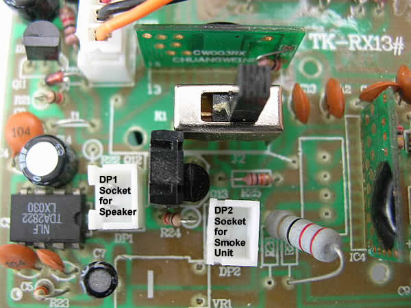

There are two versions of the Rx13 board: one has the power transistor on it (D882) and one doesn't. The one that has the power transistor on it is matched with a non proportional smoke unit that only has two resistors on it's small board. The Rx13 that doesn't have the power transistor on it is matched with a smoke unit that has the power transistor on it's small board.
The RX13 in this attachment has the power trasistor (big black thing between the three sockets)
