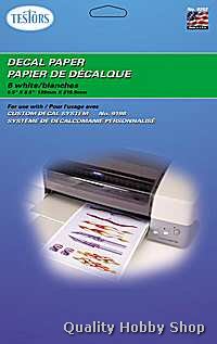

This is the half letter size,5.5"x8.5" paper. slightly bigger than A4 The software screen has a border scale which matches this size. I would like to find a less expensive quality paper.This pack is 8.00us online and 9.99us in the local shop.
JRC would you have a link or brand name of the paper your referring to? I would like to purchase some paper for less money. An 4sheet pack of letter size paper is 9.99 as well. cheers Blake
5.5"x 8.5" paper
5.5"x 8.5" paper
decal paper.jpg (12.45 KiB) Viewed 2184 times

hi Sax
there are a lot of suppliers on ebay, for example 20 sheets A4 waterslide at $13.65. So for less than 70 cents a sheet you can have your own decals. I've used them for a while and managed to collect a good number of images of Panzer Division markings which can be resized for any scale.
It's the same with flags, I use A4 sheets of silk and print straight onto that.

Post by Saxondog »
Thanks Ross, I will check it out. My concern with other brands was quality and waste. Ink is expensive and if I wasted it on sub-standard paper well you see my point. But the information you have posted gives me the confidence to try these other brands of paper.Did not realize printing on the silk screen material. Excellent advice,Thanks Blake
