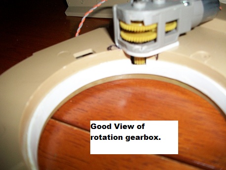

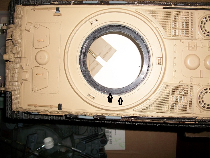

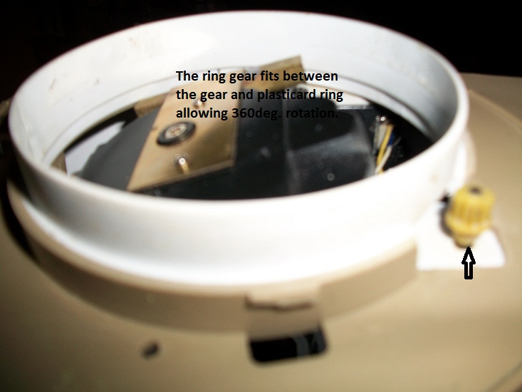

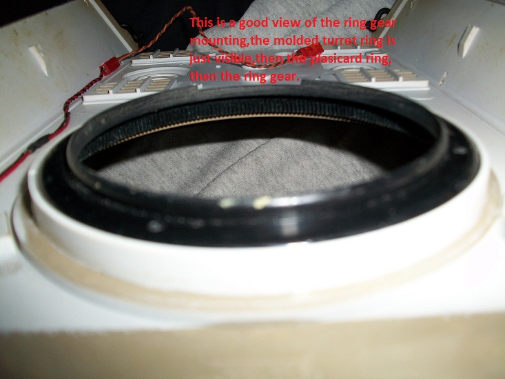

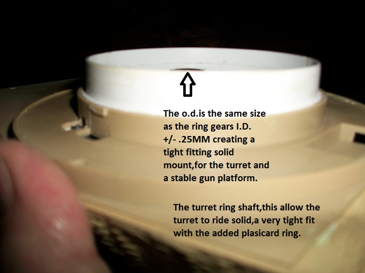

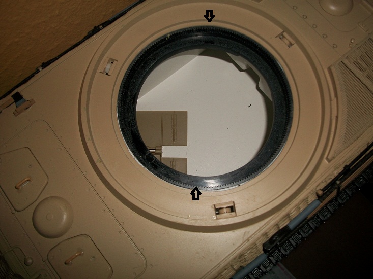

Their is a modification that was described to me and then I purchased a Tank from the person. It allows the speed to be adjusted and allows the turret removal with out separating the hull.Turret lifts off from any position.The gear box is a Tamiya kit which allows different ratio combinations, which in turn allows turret speed modification.The ring gear is from a Panzer IV.
Turret ring 009.JPG (93.59 KiB) Viewed 3736 times

If were talking about H/L then the resistor may be the best solution, but even the H/L could use the gearbox from the mod listed above replacing the H/L rotation unit with the Tamiya gearbox,their are 4 ratios possible with this little gear box,mounting is simple either use plasticard or glue directly in the space where the H/L unit is mounted. Since the H/L ring gear is removable the different gearbox will not effect disassembly.
