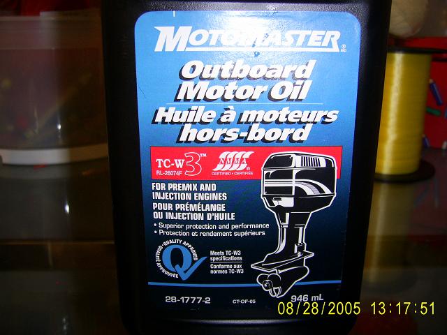

Like you I tried a lot of mixes without success ...
I finally decided to go for the real thing without mixing ...
I'm using outboard motor oil for 2 strokes engines ...
It's ink blue and liquid enough to work with the wick ...
Of course the major inconvenient is the smell ....If you ever spilled motor oil on a hot car engine while adding ; you know what I mean ...
On the positive side ; besides the color ; it does't produce any liquid residue at all and last at least 4 times longer than the fog juice I was using before ....
I'm running some intensive tests with it and time will tell if it's a good idea or not .... :/ :/ :/

strmnd54
Posts: 214
Joined: Mon May 24, 2010 3:00 am
Re: Home-made smoke&sound
Post by strmnd54 »
I've been trying to upload a pic of the oil without success ...The file was too big ...
Let's try again ....

Thanks for the tip Blake ....There must be a lot of automotive products on the market that would do a good job ...You know me , I'm not afraid to experiment ....
One of the interesting side effect of this oil is the absence of liquid residue clogging small diameter pipes ....
Come to think of it ;It shouldn't be a surprise since most of those additives are designed to burn as clean as possible due to environmental restrictions ....
I believe it would work well with any smoker design using a resistor as heater element , although it's too early to assess the long term effects on the kevlar wicks ...
I plan to run my unit as often that I can for the next couple weeks and then take a look at the heater element ...
I'll keep you guys posted ....
