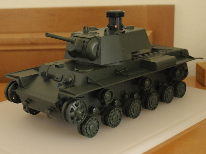

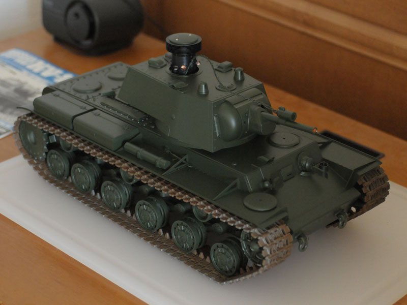

This is a work in progress photo brief for the Tamiya KV-1.
Parts List:
• Tamiya KV-1 RC Full Option Tank
• Tamiya Battle Unit with the LED Emitter Clip on Device
• Impact Metal Tracks and Drive Sprockets

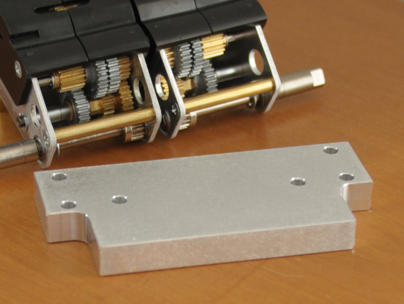

• Daryl Turner Gearbox Mount Brace
• Daryl Turner Metal Elevation Arm
• Daryl Turner Front and Rear Hull Brace Supports
• Daryl Turner Spring Loaded Idler Return System
• Idlers Machined for Bearings
• Schumo-Kits Plastic Fender Supports
• Futaba SkySport 2.4 Radio
• Andrew Designs Soviet Tanker Resin Figure
• LED Emitter mounted atop the barrel to play better & conform at the larger USA RC tank club battles. I prefer placing the emitter in the barrel and making a long wire lead emitter to successfully do so, but times & rules change.
The model will be airbrush painted and weathered to represent a weathered tank from the 51st Tank Battalion, Leningrad, Early Spring 1942.
The fun for me with Tamiya rc tanks is building, painting, weathering, running and battling these WWII tank models against each other in the backyard. Otherwise without the TBU, I find armor models somewhat boring, but that is just my opinion.
:D :D :D
So, in July 2009 I decided I wanted to build a WWII Soviet foe for my German panzer: the Pz4. And I finally got around to starting the process last month, when I got the kit for my birthday from family and the wife.
Enjoy, John

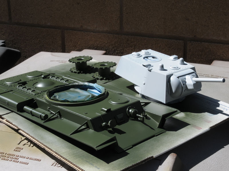

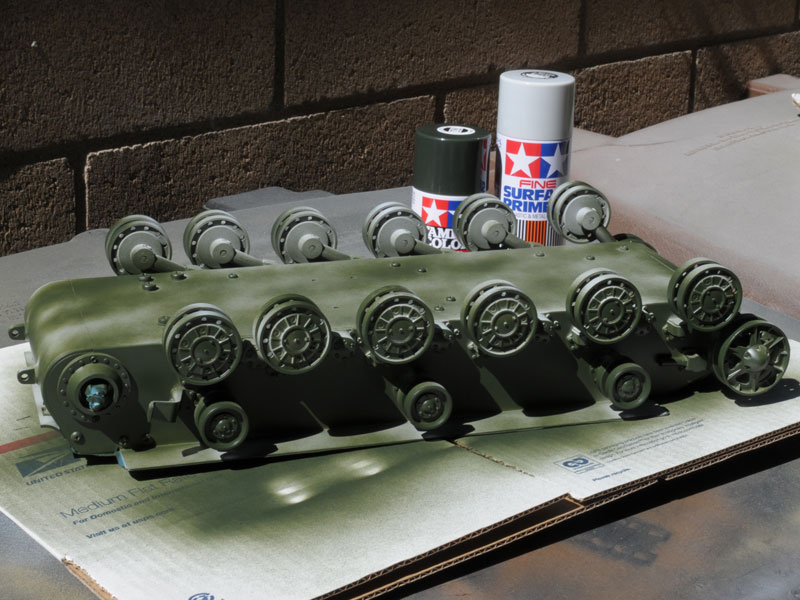

13 Primer-Hull-1.jpg (47.16 KiB) Viewed 6947 times

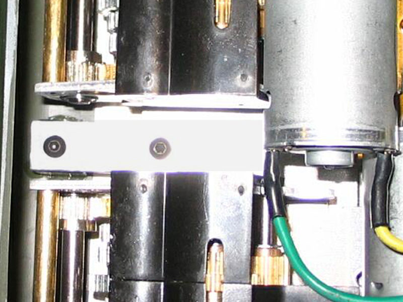

12 Gear-Box-Brace.jpg (61.73 KiB) Viewed 6947 times

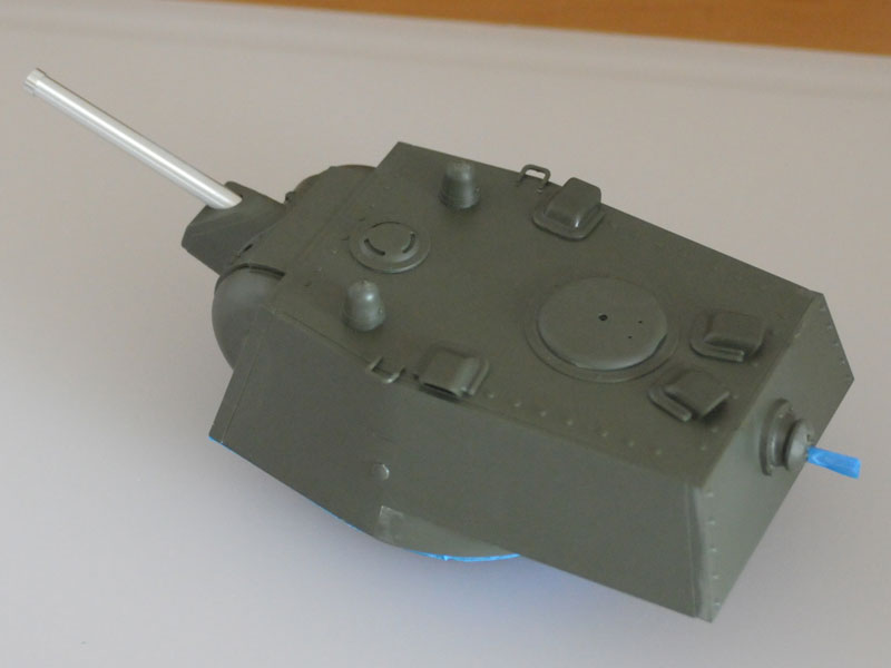

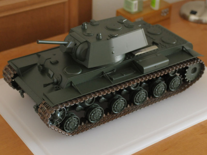

And now the model is ready for fun: painting and weathering.

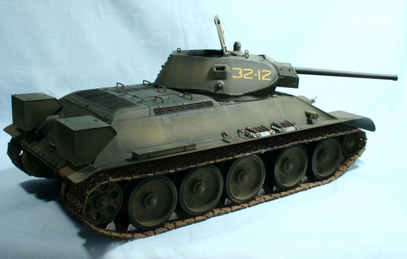

Change of finish paint plans: will paint to match this 1/16 scale T-34. :thumbup:

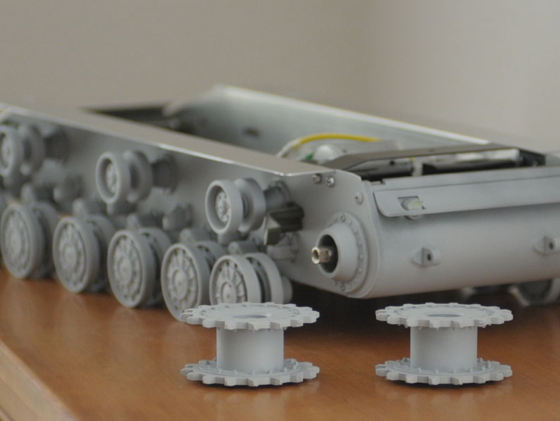

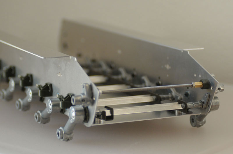

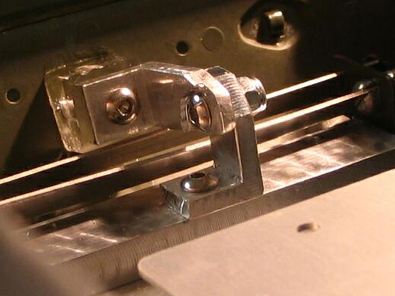

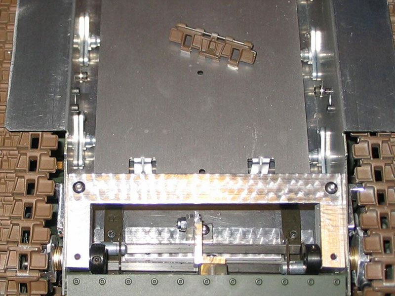

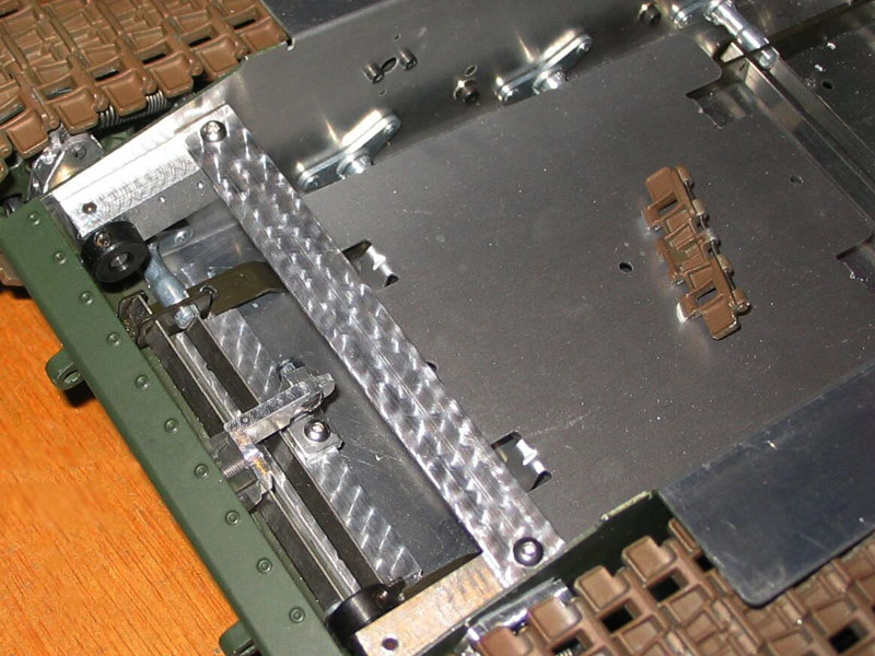

Tamiya did not support or brace the front of the KV-1 kit's hull.
While the stock kit's hull & idler setup is certainly good enough for running around outdoors, it seems less than robost for the fun abuse of rc tank club battle play; or dealing with more challenging backyard terrain.
To improve on this kit's hull – suspension and and turn it into a powerfully built; sturdy; trouble free performing model that will better withstand the abuse of pretend rc tank combat; I shipped the hull off to Daryl Turner.
He has designed and machined a custom front hull brace and a pair of new machined idlers with a spring return setup. While not difficult to install, he used my hull to do some advance parts prototyping and was kind and installed the new parts for me. The goal is simply to keep the Impact Metal tracks on during the critical moments of a play rc tank fight and not become a static pill box!
And die...
:haha: :haha: :haha:
New machined idler setup
KV-1 Front Support Brace

wow that looks nice and strong ,i cant see that flexing
regards, cliff

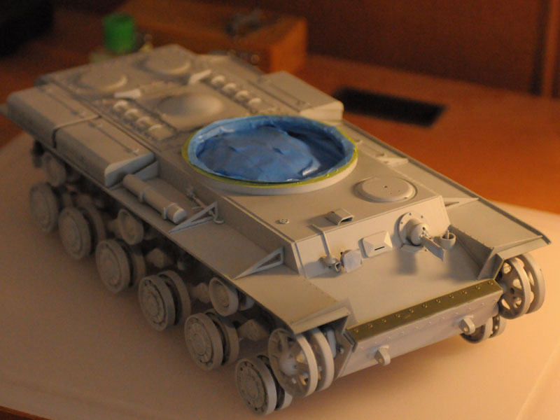

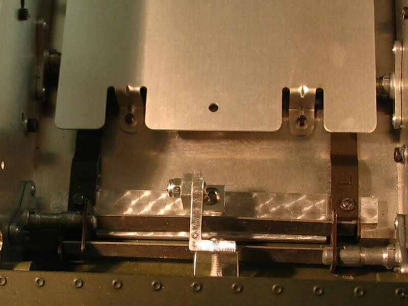

Correcting a little kit problem: Tamiya KV-1
Post by Pcomm1 »
The glacis plate on the Tamiya KV-1, the front hull of the tank, does not have a proper way to anchor it in place.
It mounts to the hull sides, towards the top, with 2 screws. Then the plate will rotate up and down like a visor on a knight's or motorcyclist's helmet, which is OK for them and not good for my model. LOL.
The photos show a simple fix.
John

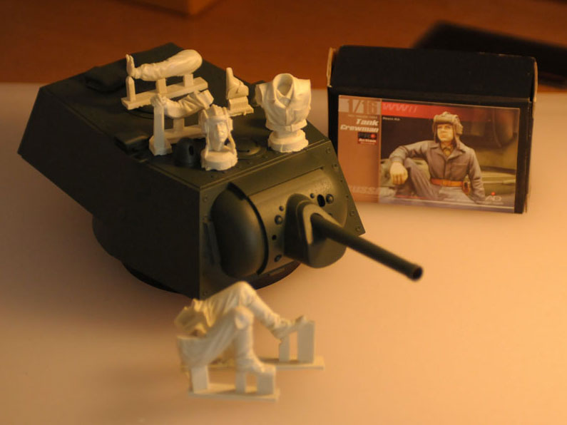

Andrew Design Russian Tanker: Tamiya KV-1 + TBU "Runner" Bui
Post by Pcomm1 »
In the spirit of Halloween. :haha:

Update: Tamiya KV-1 Kit Issue Fixes
Post by Pcomm1 »

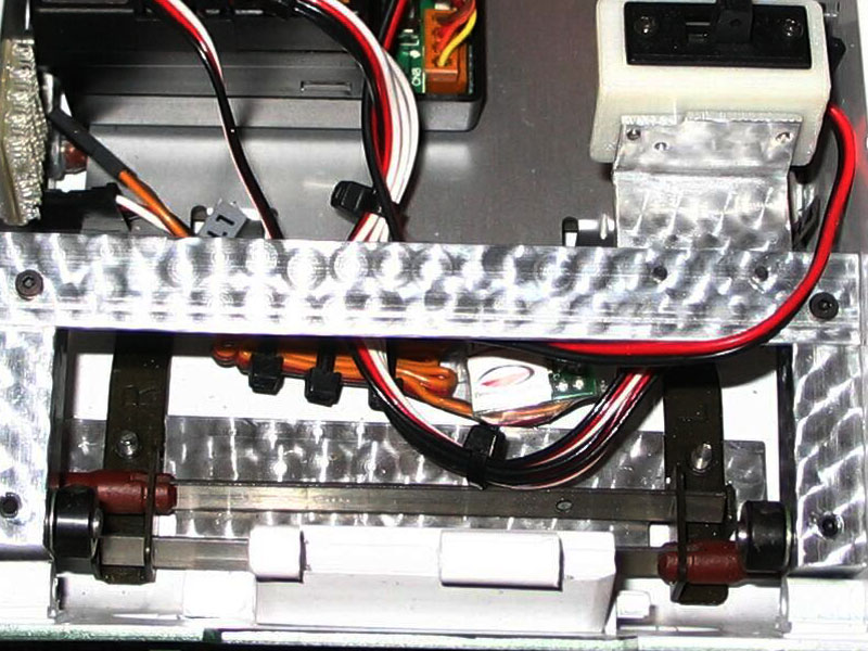

• The photos show the completed "runner" front and rear hull bracing and a hint of the new spring loaded idler return system.
• The Tamiya KV-1 built stock works pretty good, I just did not like the front and rear sections rotating up and down like a knights helmet visor, LOL.
• Plus, running Impact heavy metal tracks, the KV hull and idlers do need some help.
• Up next and in base paint color right now, the model will be airbrush painted and weathered to represent a tank from the 51st Tank Battalion, Leningrad, Spring 1942.
John
