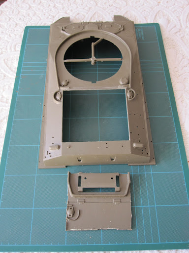

This will be a slow build as I work for myself and always seem to have something to do around the house, but I will do my best. Have got several ideas on the project and have accumilated many aftermarket parts, as I have had this kit for about 5 years.
I will be adding main gun recoil using the MF-03 unit, and have a 1:16 scale Oddball figure to sit in the commander hatch.I will be fitting the obligatory battle system too.
Since joining this forum, I am now aware of the different suspension system on Oddballs tank
(Thanks Mark ;) ) But don't think that will be getting done at this stage.
Well, here goes.
First it was out with the Dremel to cut out the engine deck, then tidy the edges with modeling knife and files.
Then cut some lengths of Evergreen strip to form support for the new deck, fixed them in place with Platic Weld.
First test fit of new engine deck looks pretty good, even if I say so myself :{

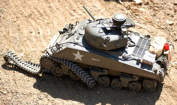

I very much have to disagree with you there John. I've modded the VVSS suspension from a Mato kit onto my Tamiya. They now work completely prototypically, and are completely solid. I run my Sherman nearly everyday, and the bogies perform perfectly, and look correct for a Normandy Sherman.
The HVSS set in the Tamiya kit is very good, but they were in such limited numbers in the war.
The only problem I have with the Mato bogies, is the wheels are slightly oversized, but i'm sure some inventive aftermarket company will release some new ones eventually.
Sparks, you can see how I converted the Mato bogies in my build thread here;
http://www.rctankwarfare.co.uk/forums/v ... =21&t=5156" onclick="window.open(this.href);return false;
Cheers,
Rik
