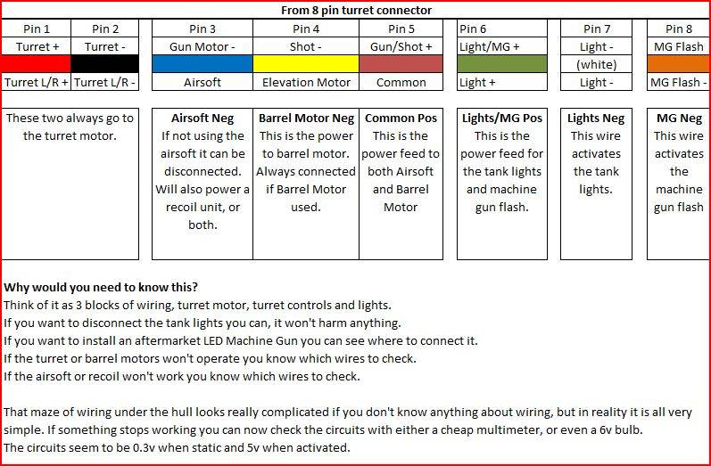

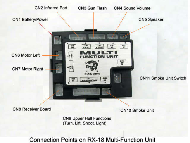

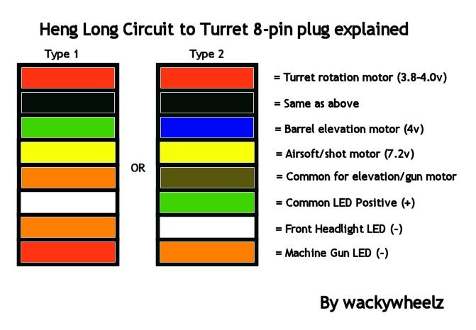

Gerwyn, here are the Diagram I mentioned. If you need help I'm online most of the day. cheers Saxondog

oldfeller
Posts: 312
Joined: Wed Aug 25, 2010 9:49 pm
Location: Rhondda Valley, South Wales
Re: yes my first Tiger 1
Post by oldfeller »
hI Blake
Cheers Mate.
Thank you for the wiring diagram.
Gerwyn
