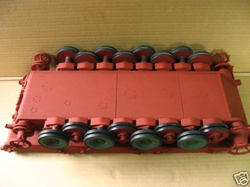

Hi Saxondog,
These kits are definitely NOT RC'able. I built the Maus and, although the resin parts are very good, they are very brittle. The suspension, wheels, tracks, etc. are all resin and have to be glued together. There were no moving parts on the Maus when completed. Could be ok as template for plasticard or ally build but would be more cost-effective to scale-up a 1/35.

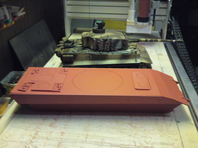

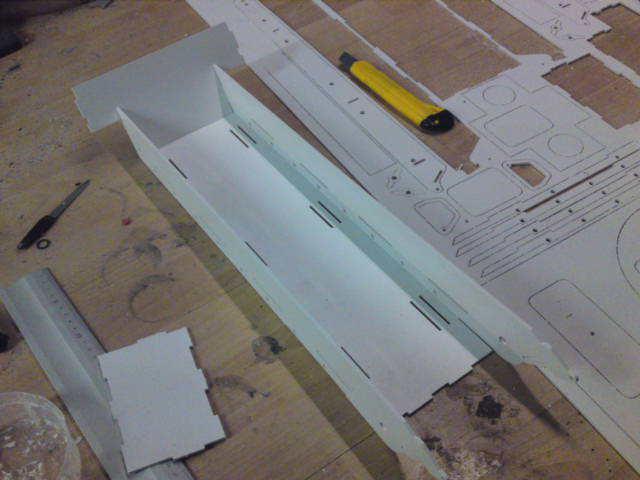

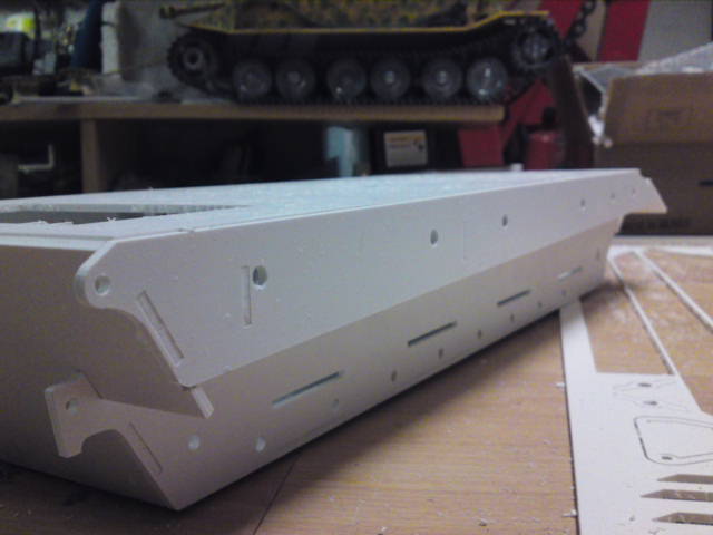

moin
the next evolution step of my e-100 hull.
cu christian

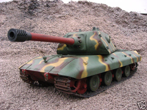

Hi all
Just a quick pic of how far i have gotten with my E-100 stug
So need help with the gun barrel ...any one realy good with a laythe and ail bar ?
