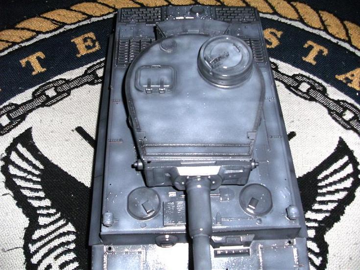

This is what I use,recommended in the painting and weathering section, First Johnsons floor polish seals all the colors and decals if left to dry for at least 24hrs. But when you apply the Matt Varnish the finish become very flat and looks like steal. It's hard to put in words but it does the job very well. The Painting and weathering in grey post shows some before and after shots,I was upset with the glossy look the floor polish caused on my Tiger. But when I sprayed the VARNISH and let it sit for a day it was a different tank,i WAS AMAZED AT THE FINISH. This technique is proven with acrylic or enamel paints.
Saxondog
BEFORE MATT VARNISH/ JOHNSON'S FLOOR POLISH
Klear coat stage 001.JPG (149.84 KiB) Viewed 830 times
AFTER MATT VARNIXH
AFTER MATT VARNIXH
13COMPANY TIGER S-13 GROSSDEUTSCHLAND.JPG (119.72 KiB) Viewed 830 times

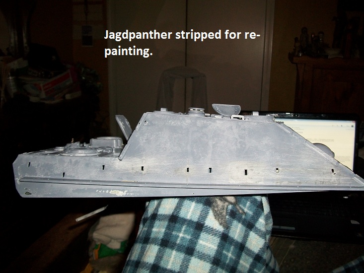

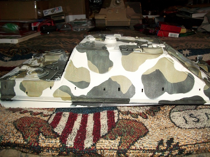

And no matter what you do, Easy-off oven cleaner will strip your tank back to plastic with out harm to the tank.
Before stripping
Before stripping
Jagdpanther camo pattern 4 008.JPG (286.55 KiB) Viewed 811 times
After Stripping
After Stripping
Jagdpanther strip 001.JPG (173.99 KiB) Viewed 811 times
