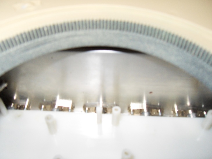

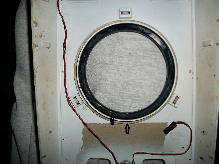

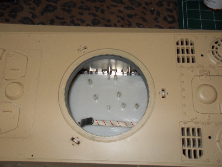

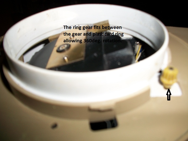

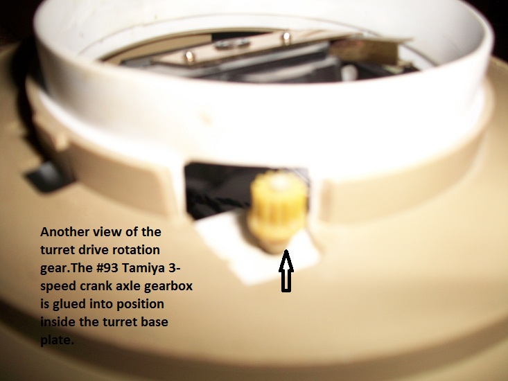

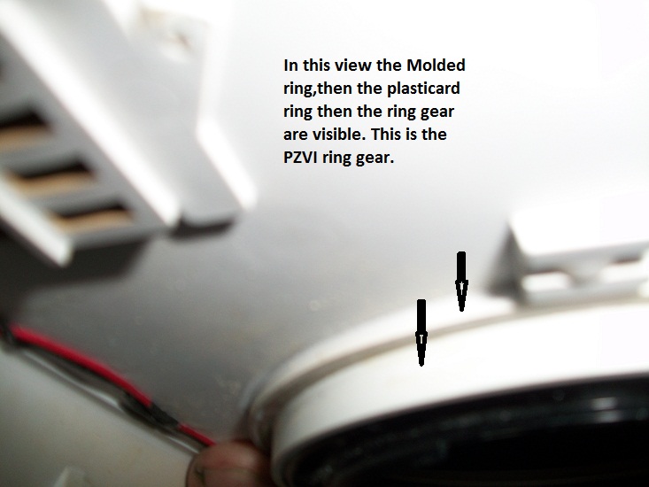

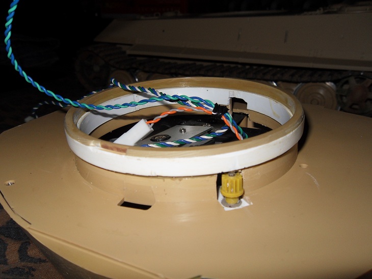

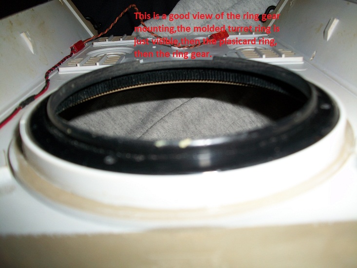

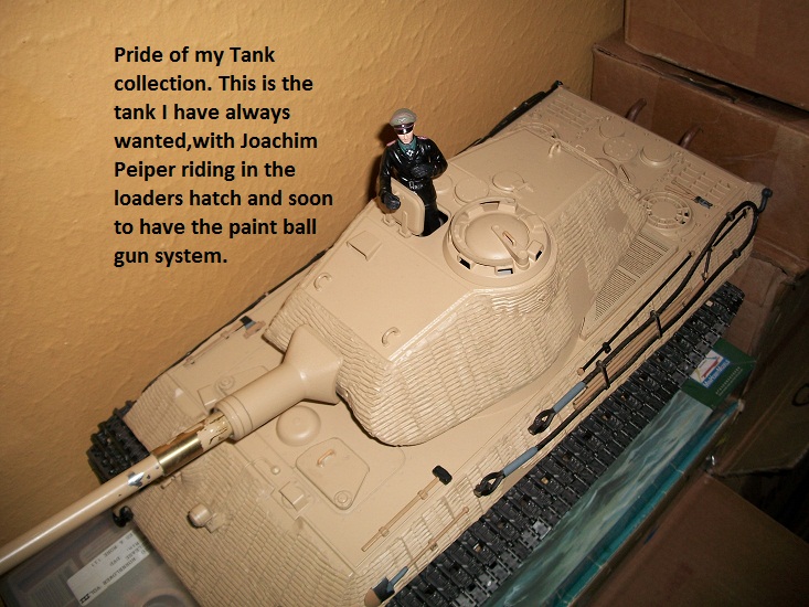

THIS MODIFICATION WAS BUILT BY Bubbajoe and then copied by me and Dietrich in our King Tigers and soon My Tiger VI S13. This is done by mounting a Panzer-IV Ring gear flush with the deck. the the turret base is built up with plasticard and slotted for the gear-motor which is a Tamiya 3-speed crank axle gearbox #93 TAM-001-000. This gear-motor is simple to build and cost under 8.00us. The best thing is more controllable rotation speed, the turret has 360deg. rotation and can be removed in any position. This is the best way I have found to modify the turret on any tank. cheers Blake

Andy this mod works very well, if you need more detailed photos just ask and I will take a few. Bubbajoe is a smart guy, and has helped me many times in building these two KT's and I want to be clear these were his mods which I copied in other tanks. If you follow the mod you will love it,the ring gear mounting requires a little trimming but once installed looks great from the top. cheers Blake

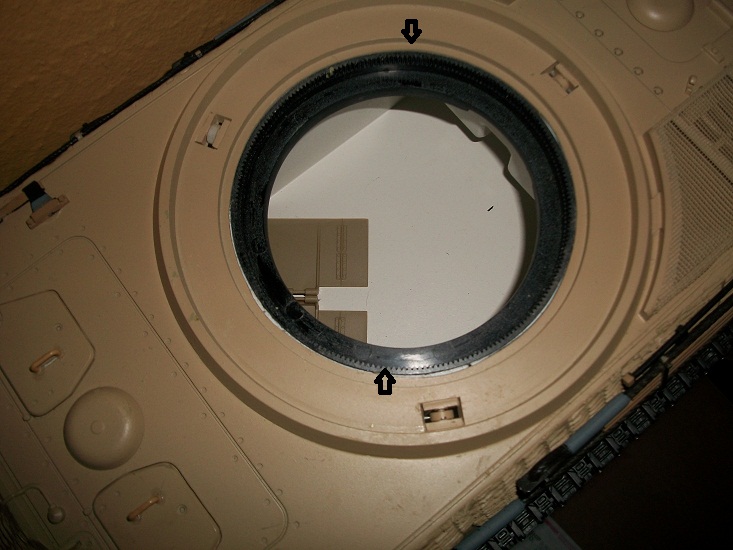

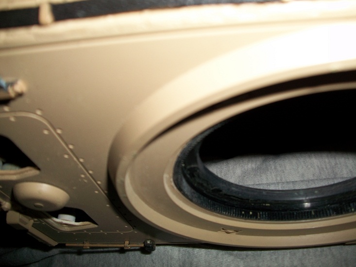

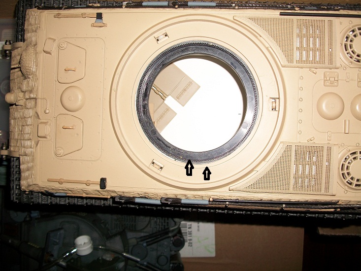

that is really cool! Is the turret locked to the hull somehow from below?

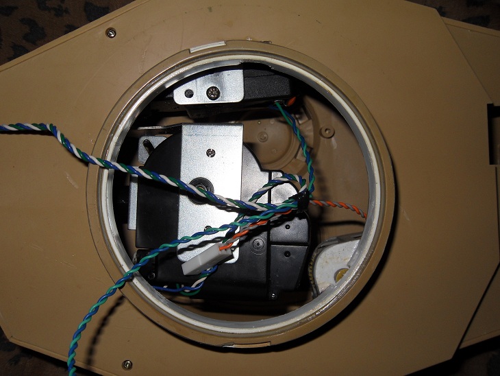

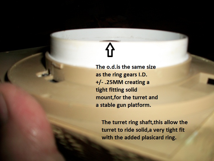

The Porsche King Tiger Version of the Bubbajoe Turret modification. This system really works well, and the added benefit of 360deg.rotation and removable turret solves many problems and creates an easy access to the inner hull. XRAD the turret does not lock in but does not bounce around as the turret ring is tight against the ring gear section in the lower hull.
