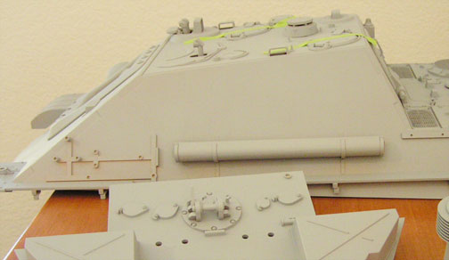

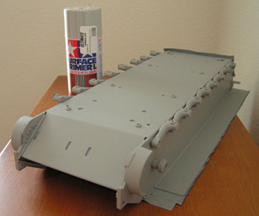

I like to use the Tamiya spray can paints for the primer steps. From the cans, I spray 3 or 4 very light coats to get good coverage. For a model that you run and enjoy, you need a good tough surface for further paint layers to sit on and avoid paint chipping.
A true statement for 1/35 armor models, but not so true at 1/16 scale: it is a myth to worry about spray can paint build up obliterating the models fine plastic details if you spray several light coats of paint. I also use Tamiya spray can paint to put down a base color prior to any camo and or weathering.
The spray can primers I like (1 can of each):
1. Tamiya Undercoating for All Metal Parts (hull and barrel)
2. Tamiya Fine Surface Primer for Plastic and Metal Parts
3. Appropriate spray can paint base color

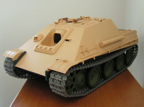

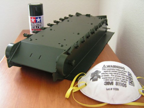

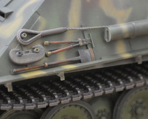

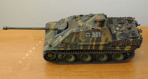

Here is a quick overview of the paint steps used for my Tamiya Jagdpanther, built for TBU fighting. I use water based artist acrylic paint for the pioneer tools and other details.
So, a combination of spray cans, airbrush and paint brush works for me. I usually seal my final paint with a dull clear finish, any color shift just adds to the weathering effects, but the main purpose of a dull flat final finish is that all your paint effects and any decal work will appear to be on the same surface.
