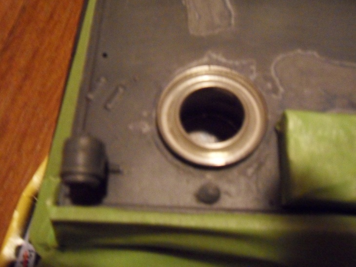

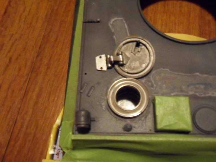

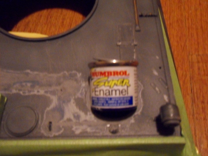

Really like your Tiger,paint scheme is very well done. One thing I noticed were you front hatches and how they were installed. Below is how I made steel rimmed hatches using Humbrol paint tins,they fit the inner hatch ring on the metal hatches perfect. Saxondoghttp://www.rctankwarfare.co.uk/forums/viewtopi ... rol#p50446" onclick="window.open(this.href);return false;
