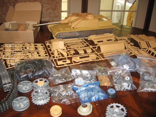

In my mini Alkett (basement workshop) I have a new tank brewing....(won;t get to it until Nashorn finished)
Tamiya hull and suspension(waiting on set of road wheels from Tammy USA and Scre bags from Japan)

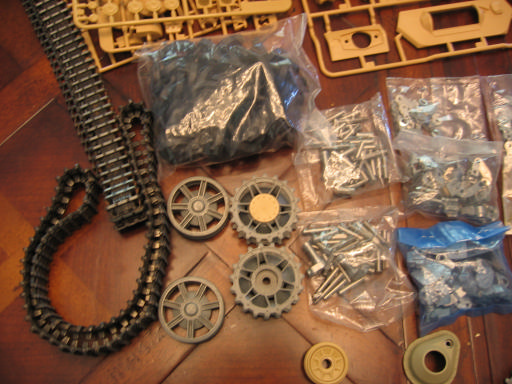

Welsh Dragon Stug IV kit. Pretty inclusinve of all major superstructure parts in metal /plastic/resin aluminum barrel and brass supressor..NIce kit!
Tammy drive wheels fit HL metal tracks perfectly. Have not decided on tammy or asiatm drive units...

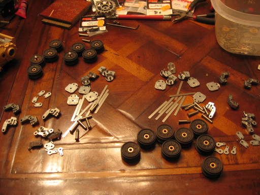

Suspension mod: I felt the stock suspension springs were too soft for scale weight. So what I did was get another set of suspension bars from AAF (very fast shippers!) and cut them in half. then added an extra half bar to the front of each mount (look closely and you can see the doubled bars)
Works great.
It is a huge PITA to gather all the parts for the Tammy P-IV suspension and hull and I don;t think I will ever build this hull again without the whole P-Iv kit, even though it does save money if you are not using tammy upper hull and other bits.

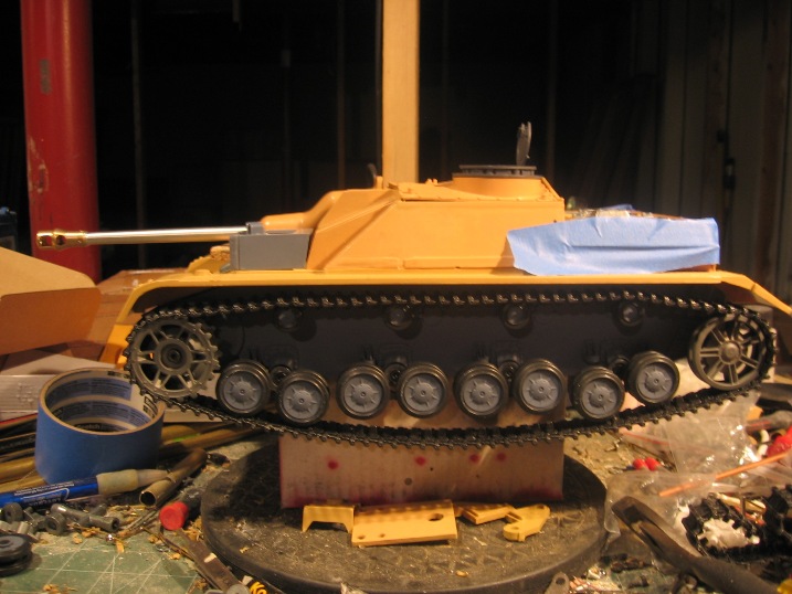

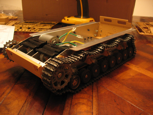

Converted back to HL hull
- IMG_4881.JPG (105.56 KiB) Viewed 3183 times
- IMG_4880.JPG (111.74 KiB) Viewed 3183 times
- IMG_4879.JPG (110.87 KiB) Viewed 3183 times

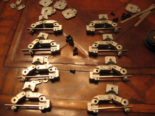

- upgrade suspension: best buy for ~40$. Throw away the screws with the kit and reuse the nice HL allen head screws for the road wheels and hull mounts. Hardly any play compared the HL stock and they look much better. Drop of CA to hold hull mount screw and drop CA to hold lower spring retainer. each suspension group has THREE springs, two hidden coil springs and one leaf spring (visible)
- IMG_4887.JPG (99.22 KiB) Viewed 3183 times
