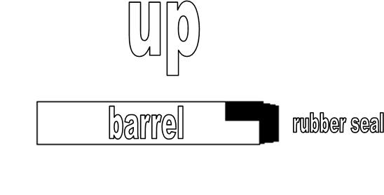

Hi, Iv been messing about with the airsoft gun on my Tiger, lengthening the inner barrel basically. I was trying to do firing tests with different barrels when this little rubber bit of tube came out. Its 5mm long and in the last 2mm it curves inward, inner dia is 6mm and outer is maybe 7? I cant find where it went and the gun doesnt seem to work well without it, anyone know or could post a pic of the breach area of the gun from any HL tank?

Hi Dave I had this bother as well when I lengthened the barrel on my tiger if i remember right that bit of rubber goes in the airsoft unit where it meets the inner barrel so no air escapes through there you will have to lengthen the inner barrel to the correct length.

Stock Rubber Seal
Stock Rubber Seal
bbl orientationf55.jpg (10.35 KiB) Viewed 549 times
Hope this helps,Sax

Nice one guys :thumbup: I will have a look later to see if I can put it back.

Seems to have worked so thanks guys!! Stevie, what did you use for the lengthened inner barrel?? Im really struggling to find a decent match anywhere.
