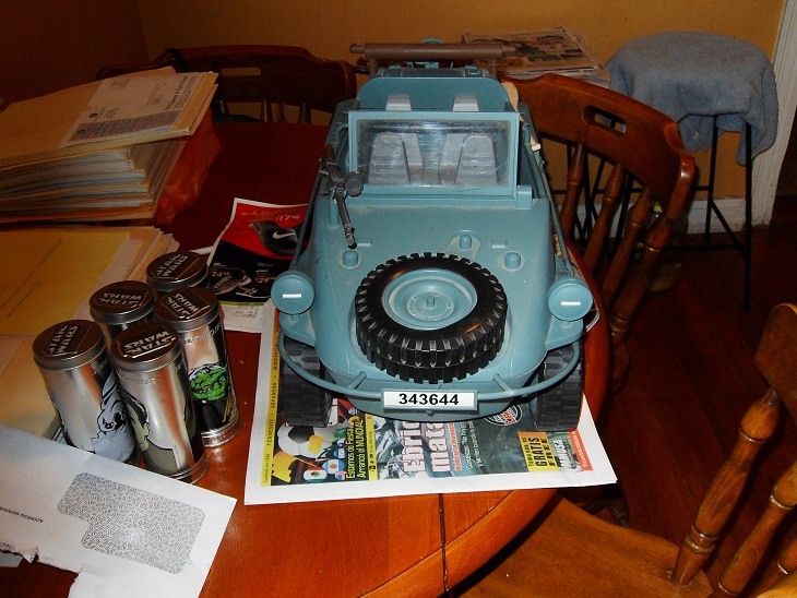

Very cool as always, I have a 1/6 scale SchwimmWAGEN and have considered conversion to RC. i don't recall if you have converted one of these or not? Any suggestions?
Regards Blake

Haven't had one of those in my grubby little paws yet. If I was to get a Schwimm it would be a DML one and a kit over the prebuilt. Put a 21C schwimm beside the DML one and the difference is a clear as night and day

I did not know that,this one was just sitting at the local shop and I paid 15.00 for it. Thought it would go well with my Tiger. Would much rather have a Kubelwagen. sax

Just camo it and load it down with figures and gear then drape it with some camo netting or leafy branches and will hardly notice it. The wheels should be replaced though. Still even though it's a 21C still better than haveing no Schwimm
