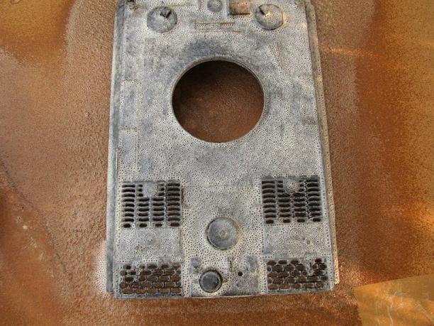

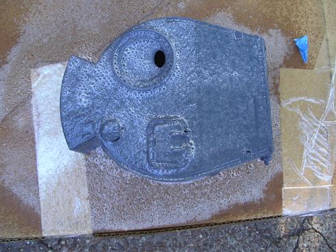

Re: Paint stripping help needed
]Oven Cleaner at work,tooth brush and a pan of hot water will strip to plastic.
